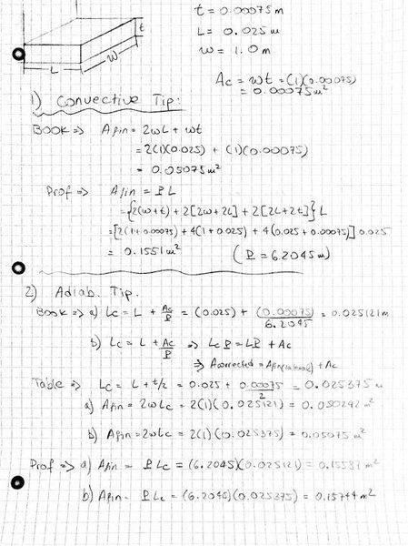

I am working on a project and I am having difficulty understanding a concept
I have to analyze a rectangular fin in 2 cases (Adiabatic tip AND Convective tip) and I am having difficulty understanding which surface area to use.
For the first case, I want to find Afin which according to my book is:
Afin = 2wL + wt -> why does it not include the lateral sides (2*L*t)? It's just the top, bottom and front surface.
Schematic: http://imgur.com/YgfHmUw
Same thing with the corrected length Lc.
The area with the corrected length is Afin=2wLc -> but this now only includes the top and bottom surface (i get that I don't include the tip because it's adiabatic) but still no lateral sides.
My professor taught me this formula: Afin = P*L
where P is perimeter. This formula includes all 4 sides and then we can add the tip cross section if needed.
Someone please explain the difference.

Thank you for the explanation. However my professor taught us that the "easiest" way to calculate Afin=PL - where P is perimeter of cross section.
If I am neglecting the sides, then that formula should not apply. Yet, I've seen it used with rectangular fins (not just circular) hence it's confusing. One side is telling me to exclude the side area, while the formula taught does include it.

Here's the calcs I did, and the diagrams I was referring to ("book" and "table")

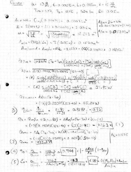

Here's the scope of the project and my initial calcs, this is the same way we do it in class.
  • Term_ProjectENGI3454March62016-97366.pdf

The differential equation in post #9 can readily be rewritten as:
$$\frac{d^2(T-T_0)}{dx^2}-m^2(T-T_0)=0\tag{1}$$where $$m=\sqrt{\frac{2h}{kt}(1+t/W)}\tag{2}$$Note the factor of (1 + t/W) in Eqn. 2, which you were lamenting was omitted from the equation in your book. They simply neglected the t/W with respect to the 1. To make you happy, we will not neglect this term in our development.
Eqn. 1 represents a 2nd order ordinary homogeneous differential equation with constant coefficients. For the adiabatic end case (at x = L), the boundary conditions are T = Tw @ x = 0 and dT/dx=0 at x = L, where Tw is the temperature at the base of the fin. The solution to Eqn. 1, subject to these boundary conditions is:
$$\frac{(T-T_0)}{(T_w-T_0)}=\frac{e^{m(L-x)}+e^{-m(L-x)}}{e^{mL}+e^{-mL}}\tag{3}$$
From Eqn. 3, the temperature gradient at x = 0 is given by:
$$\left(\frac{dT}{dx}\right)_{x=0}=-m(T_w-T_0)\tanh{(mL)}\tag{4}$$
So the rate of heat flow to the fin (and from the fin to the surroundings) is given by:
$$Q=Wt\left(-k\frac{dT}{dx}\right)_{x=0}=(T_w-T_0)kWtm\tanh{(mL)}\tag{5}$$
The rate of heat flow from the fin to the surroundings is also given by:
$$Q=h(2W+2t)L\eta(T_w-T_0)\tag{6}$$ where ##\eta## is defined as the fin efficiency. If we combine Eqns. 5 and 6, we obtain:
$$h(2W+2t)L\eta=kWtm\tanh{(mL)}\tag{7}$$or equivalently,$$\eta=\frac{\tanh(mL)}{mL}\tag{8}$$
This completes the analysis of the adiabatic tip case. To solve the problem where the fin has a convective tip, we need to modify the boundary condition at x = L to now read: ##-k\frac{dT}{dx}=h(T-T_0)## @ x = L. Do you think you can solve the differential equation for this modified boundary condition, and then determine the modified fin efficiency?

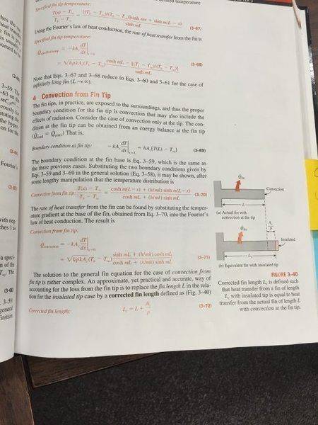

Then it goes into different cases and their solutions (see second picture).My professor copies the textbook, doesn't explain any of the steps and whenever we ask questions he just refers us to his notes or the book.

ksukhin said:
Yeah...seems like I'm going to fail this class because I have no idea what's going on. I am trying to follow your derivation and what my book has and nothing clicks.
I get the idea of boundary conditions. When x=L my BC becomes Qcond = Qconv.
My book doesn't offer any explanation at all. It just states the same about eq (1), it's a 2nd order ODE and the solution to it is:
T(x) - To = (C1)e^(mx) + (C2)e^(-mx)
I appreciate the help, but I'm at the point where I'm ready to say f*ck it, memorize the formulas and hope for the best.
