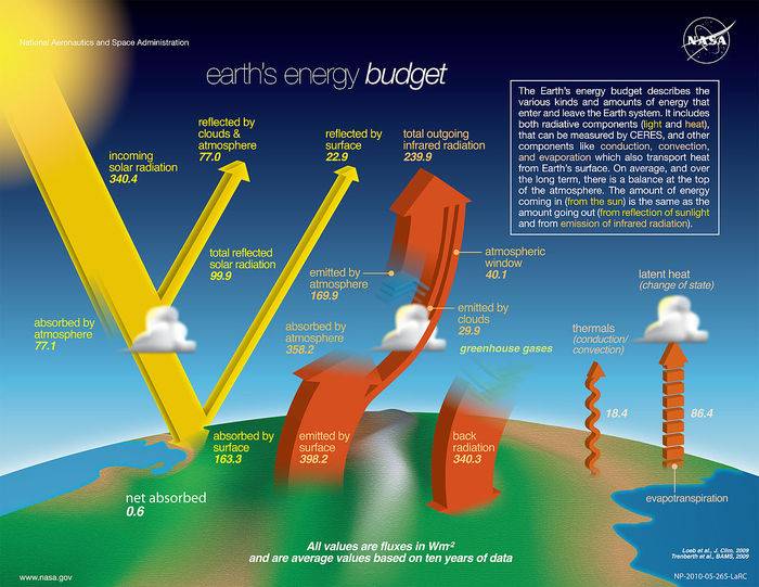

Why does the heat in the atmosphere mostly go down?
In summary, the conversation discusses the greenhouse effect and how heat is transferred between outer space, the atmosphere, and Earth's surface. The wiki article on the greenhouse effect explains that the atmosphere radiates energy in both directions, with a majority of the energy going towards the Earth's surface. The conversation then discusses the different forms of heat transfer and how they contribute to the movement of energy. It is determined that radiation is the main form of heat transfer in this scenario.

Hi DrPapper,
In the illustration, it shows 350 (Watts per meter squared) absorbed by the atmosphere. If this is all re-emitted, half up, half down, that accounts for 175 of the rising 195 from the atmosphere. That would also account for 175 of the descending energy. There's another 149 that goes down, and only another 20 that goes up. It still seems more goes down, strangely.
Now to your prompts. Which type of heat can go into space? Radiation only, because there are no atoms to carry the heat (or sound). So I guess that's the solution. Any heat will not pass into space. Imagine heat being created high up, by the absorption of some incoming solar radiation by the atmosphere. At the boundary with space, the heat can only go down. The radiation heated air releases goes equally up and down. So I guess it makes sense more energy flows down from the atmosphere than up in this diagram.
Thinking of an incandescent bulb or a candle, the heat goes out by conduction to the surrounding cooler air, by radiation of its visible light and infrared radiation, and I can imagine eddies of convection in the room, perhaps when the rising heated air hit the ceiling, but I haven't seen evidence for convection currents around a light bulb or candle. I do see convection currents in the candle's liquid puddle of wax around the burning wick. Here specks of black burnt wick swirl.
Does this reasoning make sense?

stfaivus said:
The wiki article on the greenhouse effect (https://en.wikipedia.org/wiki/Greenhouse_effect) has a top illustration which shows the flow of heat and energy (Watts per meter squared) between outer space, the atmosphere, and Earth's surface. The illustrations shows that of the 519 in the atmosphere, 195 (38%) goes up into space and 324 (62%) goes down to earth. The article writes "the atmosphere radiates energy both upwards and downwards; the part radiated downwards is absorbed by the Earth's surface." I believe the infrared radiation absorbed and emitted by the greenhouse gases goes half up into space and half down to earth. Does the heat then mainly go down because up is empty space and down is thicker air. This is weird to me because I am used to heated air rising?
I believe you are misreading the diagram.
The atmosphere is between the Sun and the Earth surface and plays a role in the transmission of energy from the Sun onto the Earth. The atmosphere is also between the Earth and space, and plays a role in the transmission of energy from the Earth surface to space.
You and Wikipedia are conflating the two energy flows. For the sunlight that flows thru the atmosphere to the Earth, more gets thru than is blocked. However the infrared emitted from the Earth surface that is absorbed by the atmosphere, half gets re-emitted up, and half down, just as you state. I think both of those energy flow diagrams try to show the sun incident energy and the Earth emitted in one diagram, to show that the Earth at a steady state temperature must have 343 Watts per meter hitting it, and 343 watts per meter leaving, or the temperature would change. (I believe the 343 watts per meter number is incorrect).
The Earth surface will have a black body temperature, and radiate with the spectrum for that temperature. Just as an electric stove heating element does not glow visibly at a low temperature, the Earth also only "glows" in the infrared. And just as the higher stove top settings increase the energy emitted, higher temperatures increase the emitted energy. The average temperature is a steady state temperature at which the emitted energy equals the absorbed energy, taking into account the atmosphere.
No, he's not. Here's a more detailed and more recent diagram of the Earth's energy budget:
he-NASA-Earth%27s-Energy-Budget-Poster-Radiant-Energy-System-satellite-infrared-radiation-fluxes.jpg
The atmosphere as a whole emits more thermal radiation to the Earth's surface (340 W/m^2) than it does to space (200 W/m^2). This is the correct physics. Thinking that it should emit the same amount of energy in both directions is incorrect.

D H said:
No, he's not.
Perhaps I am misreading his confusion:
"I believe the infrared radiation absorbed and emitted by the greenhouse gases goes half up into space and half down to earth."
That belief is accurate. The energy flows shown are not confined to the energy absorbed and emitted by greenhouse gases. If you look at energy that is absorbed by greenhouse gases, roughly half will be emitted with an upward result and half with a downward result. The majority of the upward energy flow in the diagram looks to be convective heat up.
Heated air can rise, but the main sorce of heat to atmosphere is the reflectión of solar radiation on Earth surface, so the nearer to the surface the hotter the athmosphere at first sight. So that is the cause to be hotter near the ground, without need to say that heat _goes_ down. It comes from below, really
Part of the confusion in this thread comes from trying to show all five of the relevant atmospheric heat budgets in a single diagram. These budgets include atmospheric inflow (solar radiation, terrestrial radiation, conduction, and enthalpic cycling); atmospheric outflow (longwave radiation to the surface, and to outer space); surface inflow (insolation plus atmospheric longwave radiation); surface outflow (longwave to the atmosphere, longwave to outer space, conduction to the atmosphere, and enthalpic cycling [see post #7]); and finally Earth'shine (emitted longwave terrestrial radiation, reflected solar radiation from the surface, and upscattered and reflected solar radiation from the atmosphere--mostly clouds).
Just taking the first of these we have the atmosphere receiving most of its thermal energy (heat, in engineering terms) from terrestrial longwave radiation (69%), shortwave solar radiation (26%), conduction from the Earth's surface (4%), and enthalpic cycling (1%). All of these percentages are approximations, and subject to amendment as the scientific evidence accumulates.
To address one persistent source of confusion, net (incoming minus outgoing) longwave atmospheric radiation varies considerably from one elevation to another at a single location, and even more from one location to another over the Earth's varying climatic regions. This radiation rarely travels more than a hundred meters or so before being absorbed by the so-called "greenhouse gases"--primarily water vapor. More thermal radiation goes downward from the denser, more humid lower hundred meters than goes upward from the more rarefied and drier upper atmosphere. You simply cannot treat the extremely complex atmosphere as a single homogeneous system.

Hi,
Thank you everyone on this thread! This seems an important and timely issue to get very clear on.
My two initial questions are more clear now, especially from the slightly more detailed NASA energy flow diagram provided by DH on #9 and the interesting discussion throughout. The diagram (https://en.wikipedia.org/wiki/Greenhouse_effect#/media/File:Greenhouse_Effect.svg) I was initially trying to interpret shows 519 for total heat and energy absorbed by the atmosphere, which moves 195 (38%) up into space and 324 (62%) down to earth. All units are Watts per meter squared. It also shows 452 absorbed by the atmosphere from the surface of the earth, 350 of which is by greenhouse gases. My two questions were: one, why does 62% of the heat and energy go down? and two, if 350 of the 452 absorbed by the atmosphere is by greenhouse gases, how are the other 102 absorbed?
The second question is easily answered by the NASA diagram. It shows 86 from latent heat and 18 from thermals, or conduction. The first question, though more clear, is still a little confusing to me. For now I can interpret the first question like this. All the energy absorbed by the atmosphere-infrared radiation IR rising from Earth (358) + latent heat (86) + thermals (18) + incoming solar radiation (77)=539-is all converted into IR. 200 (37%) goes up into space and 340 (63%) goes down to earth.Thinking about heat conduction from atmosphere to surface does not appear to be an issue, which makes sense, as most of the solar radiation is converted into heat at the surface, thus the surface is warmer than the atmosphere, and the thermal flow goes upward.
I'm still not clear on why more IR goes down. I like DH's explanation in comment #4 of how the absorbing and re-emitting of IR equally up and down by parallel parcels of atmosphere sends more IR down than up. This reminds me of how I think about sound and waves and calculus in general. Except when I thought about it more the amplifying effect with the parcels of air seems symmetrical if one assumes uniform density and greenhouse gas distribution throughout the atmosphere, so just as much IR would get bounced up as down. But of course, thanks to gravity, the density is far from uniform.
I'm guessing that because a lot more density and greenhouse gases are lower than higher, this allows us to think of the center of the atmosphere releasing its IR as lower to the ground. Then, if the IR released from the atmosphere is mainly going up, I could see how DH's parcels of air would amplify more IR back down than up.
How is this sounding? I think part of the confusion was started by me first asking about heat rising or falling, when we are talking about infrared radiation, which is different than heat. I'd call it heat's electromagnetic messenger.

That belief is incorrect. Look at the diagram I posted. The Earth's surface receives about the same amount of energy in the form of backscattered thermal radiation as the Earth as whole receives from the Sun at the top of the atmosphere. The atmosphere as a whole radiates considerably less energy than that into space.
The only way the atmosphere as a whole could radiate the same amount of energy upward and downward would be for the atmosphere to be isothermal, which it is not. There's a significant temperature gradient in the atmosphere, a drop of about 6.5 degrees kelvin per in the troposphere.

Hi everyone,
I asked to question to NASA and this was Dr. Lin Chambers wrote back:
Steven,
Good questions. Have you found the Energy Budget Story slide set at:
http://science-edu.larc.nasa.gov/energy_budget/
Though it does not address these specific questions, I think you will find it useful.
In particular, all objects emit energy according to their temperature (see Slide 29). Since certain gases in the atmosphere are opaque to infrared radiation, IR energy does not transmit very far. So the atmosphere receives IR energy from the lower, warmer part of the atmosphere; while the emission to space is from the higher, colder part of the atmosphere.
In between, you would see lots of local exchange between layers of the atmosphere, but this diagram is concerned with the net effect at the boundaries (Earth surface and space).
While hot air does rise, electromagnetic energy goes in all directions – certainly energy from the Sun comes down to the surface. IR energy similarly can go in all directions.
Have a look at that slide set, and then let us know what questions you still have. We may be able to clarify some things further."
Something that puzzled me about this was the 340 watts per square meter. I've seen the solar constant expressed as 1366 watts per square meter. The formula for Earth cross sectional area is pi*r^2. The surface area of a sphere is 4*pi*r^2. So the 340 is one fourth of the solar constant. I see that they are expressing the energy budget across the entire surface of the earth.
Likes stfaivus
Their accompanying slideshow (http://science-edu.larc.nasa.gov/energy_budget/pdf/EarthsEnergyBudget_Nov14_sm.pdf ) claims to show "earth's energy budget-A story". I also try to find and present the story of the greenhouse effect on my science arts website on climate change at: www.singingscientific.com.
Here is a remaining question about this story. Where does each energy flow come from and where is it going? For example, where does the heat from solar radiation absorbed at the surface go? Does more than half go into latent heat (evaporation) and rest go into rising long wave infrared radiation (IR)? I'm guessing this because I am imagining the sunlight hitting the Earth's surface, which is about 70% covered in water. Then again, I'm not imaging the greater back IR sent down to Earth from the atmosphere. Maybe the different sources of energy flow mix and this question is unanswerable, un-measurable and meaningless?
Exactly. Those numbers represent data averaged over the surface of the Earth, and over span of a decade.
That can't possibly be correct. It would mean the planet is always heating up, and very fast.
Why do you say that? Did you carefully look at the picture?

  • #32
The IR amount shown leaving (arrows pointing away from planet) is 343.8, the amount pointing towards the planet is 340.3
So "The atmosphere as a whole emits more thermal radiation to the Earth's surface (340 than it does to space (200 W/m^2)" is completely wrong. It's comparing just two parts of the picture, not the whole amounts.
Just think about the claim. It can't even be possible. An extra 140 W/m^2 would cook the planet in a short time. It's self evident.

  • #34
The atmosphere emits 169.9 W/m2 + 29.9 W/m2 = 199.8 W/m2 towards space, and 340.3 W/m2 towards Earth, exactly as @D H said.
The Earth's surface is emitting 398.2 W/m2...

  • #35
redo your maths and directions ... you are not understanding the diagramD
