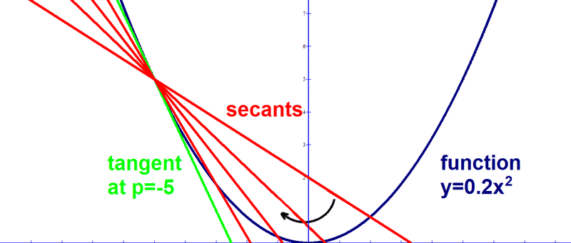

It is not a process, and we are not setting anything to zero. The "process" with the secants was only meant to visualize what a limit is.
\lim_{\Delta x \to 0} \dfrac{f(p+\Delta x)-f(p)}{\Delta x} = s
stands for a logical statement: For any given ##\varepsilon >0## there is a ##\delta(p,\varepsilon )> 0## such that ##\left|\dfrac{f(p+\Delta x)-f(p)}{\Delta x} - s\right| <\varepsilon ## whenever ##|\Delta x| < \delta(p,\varepsilon ).##
It means that we can get with our quotient - ##\dfrac{f(p+\Delta x)-f(p)}{\Delta x}## - the slope of the secants, as close as we want - ##\varepsilon ## - to the slope of the tangent - ##s## - if we are picking our second point - ##p+\Delta x ## - close enough - less than ##\delta(p,\varepsilon )## - to ##p##.
I wrote ##\delta(p,\varepsilon)## instead of the usual ##\delta## to note that the choice of ##\delta## depends on the choice of ##\varepsilon ## and the location of the tangent ##p.##
Anyway, this logical statement is neither a process nor did we anywhere replace ##\Delta x## by zero.
Let's see what my picture says:
\begin{align*}
f(x)&=\dfrac{1}{5}x^2 \wedge p=-5\\[6pt]
f'(-5)&=\lim_{\Delta x \to 0}\dfrac{f(-5+\Delta x)-f(-5)}{\Delta x}=\lim_{\Delta x \to 0}\dfrac{1}{5}\cdot \dfrac{25-10\Delta x+(\Delta x)^2 - 25}{\Delta x}=2-\dfrac{1}{5}\lim_{\Delta x \to 0} \Delta x
\end{align*}
Now, we are at a crucial point. Why is ##\lim_{A \to 0}A=0##? The logical statement says: We can get with ##A## as close as we want to ##0## if we only are sufficiently close to zero. That is certainly true, and the logical statement can easily be verified. But it is also rather trivial. We have ##\varepsilon =\delta## and it happens to be, that we get the same result if we simply identify ##A=0.## It's a matter of convenience to shorten the verification of the logical statement. And as it works, we can often make that substitution, but only in the last line of my little calculation. We did not divide anything that was zero.
