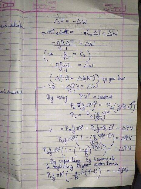

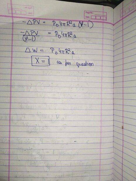

A spherical bubble inside water has radius 𝑅. Take the pressure inside the bubble and the water pressure to be 𝑝0. The bubble now gets compressed radially in an adiabatic manner so that its radius becomes (𝑅 − 𝑎). For 𝑎 ≪ 𝑅 the magnitude of the work done in the process is given by (4𝜋𝑝0𝑅𝑎2 )𝑋, where 𝑋 is a constant and 𝛾 = 𝐶𝑝⁄𝐶𝑉 = 41⁄30. The value of 𝑋 is ____
work done in a process=external pressure*change in volume
First law of thermodynamics, dX signifies change in X,
dQ=dU+dW
Q=heat energy
U=internal energy
W=work done
for any process, dU=n*Cv*dT
T=temperature of system,n=number of moles of gas undergoing the process
Cv=molar heat capacity at constant volume
Cp=molar heat capacity at constant pressure
as the process has been given as an adiabatic one, dQ=0, further attempt is given in the attached files, but the problem is I got X=1 while the official key states it to be X=2.05, could anyone explain why

I see that you didn't write ##dV=4\pi r^2a##, use this formula just as we used to do when we took the change in volume for of an elementary shell here, ##dr## can be written as ##a##
I am a scrub in thermodynamics, maybe @Chestermiller who is expert can have a look at this.
However the problem statement gives you the value of ##\gamma## (I believe that's the ##\phi## in your work) but you nowhere use the value of ##\phi ## in your work, because according to your work it gets simplified. Maybe that thing you do about keeping only the first term in the binomial expansion is wrong, maybe you got to look for another approximation.
My result for the work to compress the bubble adiabatically and reversibly is ##4\pi R^2 a p_0##, independent of ##\gamma##, exactly the same as yours. It seems to me your analysis is flawless.
Likes Twigg and Delta2
I note that in post #1 the power of 2 is on a, not R. It also seems obvious that the adiabatic aspect would not affect the first order term.

What do you get for X when you do this? I get X = 1.05
Hmm.. that suggests the author confused ##R^2a## with ##Ra^2## and added the terms together.

@bhupesh if you consider only the second order term in the binomial expansion what do you get that its coefficient is?
Twigg said:
I ended up with 2.05 (from ##\frac{3}{2} \gamma##), but I trust your work over mine
My solution for the work done by the gas on the surroundings was $$W=p_0v_0\left[\frac{(1-x)^{3-3\gamma}-1)}{(1-\gamma)}\right]$$where x = a/R. If I expand this in a Taylor series in x, I get $$W=-p_0v_0\left(3x+(3\gamma-2)\frac{x^2}{2}\right)$$which leads to X=1.05.
The reason you ended up with 2.05 is that you left out the third term in the expansion of ##(R-a)^3##
Likes Twigg
I am getting 1.05 with only second term included, neglecting the first term
@Chestermiller Oh! That makes sense, thanks! Looks like I should've expanded the volume change to 2nd order in a, and multiplied that by the 0th order in p.

We are expanding the exact expression for the work in a Taylor series to 2nd order terms in a/R. So the result is not exact; we are retaining only the first 3 terms of the expansion.
