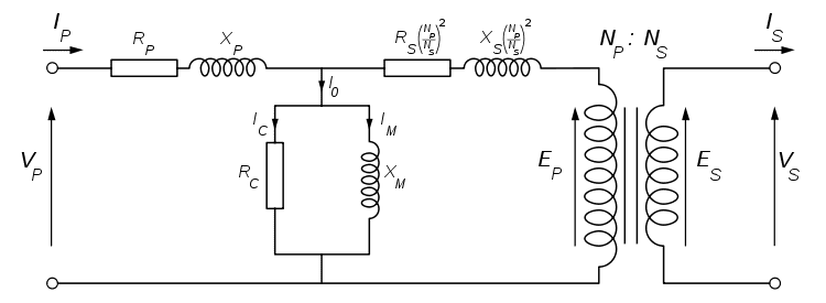

jim hardy said:Yungman - check my thinking
Iron losses in the core come out as heat so must cause an in-phase component of current. Else there'd be no net electrical energy transfer into core. P=VICos(Theta) and theta can't be 90 degrees if there's any watts heating the core.
So they will appear to be another resistance in parallel
which will show up as series in theveniin equivalent
and the DC ohms will differ from the ohms in real component of complex Z.
am i on track?
old jim
am i on track?
old jim
Averagesupernova said:I would agree that in order for heat to be generated the current would have to be in phase with the voltage. Would we look at this as a parallel resistance or a series one?
