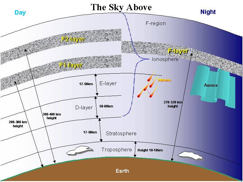

Ultraviolet radiation from the sun is the main cause of the ionisation of the Earth's ionosphere …
hence the difference in propagation seen between day and night
The Ionisation caused by cosmic rays occurs below ~ 30 km, which is well below the height of the ionospheric layers

davenn said:
No, that isn't correct.
Dave
That's right of course - I forgot the details of ionisation causes. I should have used the term "ionising radiation" and kept on the safe side!
It makes good sense about cosmic rays. There are relatively few and their effect can only be significant where there is a dense atmosphere. If there really were enough to have the same effects as UV from the Sun (which must have an energy density of many W/m2), we would surely all be frazzled.
