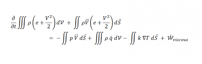

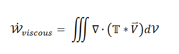

I wrote down the energy equation in integral form for the total internal energy e.
If we say the flow is stationary, equal pressure at inlet and outlet and adiabatic, then
the instationary term on the left side and the temperature source term and temperature
conduction term as well as the pressure term on the right side can be
cancelled out.
So what remains is the left side telling me the net amount of energy that leaves my volume
and on the right side the energy term due to shear stress.

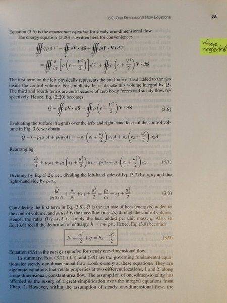

I uploaded a page from Anderson's textbook "Modern Compressible Flow", on this page Anderson
describes the derivation of the 1D energy equation. Here he simply neglects the effect
of viscosity without even mentioning it...
Equation (3.9) of this page is subsequently used for the derivation of Fanno flow where
viscosity clearly is the point of interest.
Furthermore I found some Gas Dynamics lecture notes where the author points out this issue.
See http://www3.nd.edu/~powers/ame.30332/notes.pdf page 65-66 and specially the footnote at
the end of page 66.
The author of these lecture notes points out that neglecting the viscous action is common
practice, but not correct.
When looking again at Anderson's derivation and including
the viscous term, Equation (3.9) would have an additional term. This means for adiabatic
flow the total energy entering the duct wouldn't equal the energy that exits it...
According to this thinking viscosity has an effect on the total energy, which means that is acts as a source/sink.
What do you think about that?

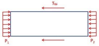

I had a look at Equation (4.31) since it is used for the derivation of Equation (4.46). This equation is used in the derivation of the equations that describe Fanno Flow.
I inserted wall shear into the energy equation as the author suggests it in the footnote by adding [itex] \tau_w L \Delta_x u \Delta_t [/itex] to Equation (4.29). With this I get a modified version of Equation (4.46) (with [itex] q_w = 0 [/itex]), that is [tex] h + \frac{u^2}{2} - (h_0 + \frac{u_0^2}{2} ) = \int_0^1 \frac{\tau_w L}{\rho A} dx [/tex]
According to this the shear stress has an effect on the energy, right?

This equation does not look correct to me. (See equation 2 in this document: www.chimeracfd.com/professional/technote/fanno_flow.pdf) According to the open system version of the first law, the right hand side of your equation should be zero for steady state operation (i.e., neglecting kinetic energy, the enthalpy change should be zero). For an incompressible liquid, the viscosity effect would be captured by the fact that vΔp is negative (the pressure decreases as a result of viscous dissipation of mechanical energy) so the temperature rises in order to maintain the enthalpy constant (neglecting kinetic energy). For a compressible ideal gas, the viscous heating is exactly compensated by expansion cooling, so here again, the enthalpy still doesn't change, but in this case, since it is an ideal gas, the temperature must remain constant (since enthalpy is a function only of temperature). What happens for an ideal gas then is that the pressure decreases and the volume increases such that Δ(pv)=0. Of course, if kinetic energy effects are present, then the enthalpy does change, and this results in the temperature changing.
For a real gas, the enthalpy is a function not only of temperature but also of pressure. So, in this case, the temperature can change while maintaining constant enthalpy between the stream flowing into the system and the stream flowing out of the system. Thus, both the pressure change (from viscous effects) and the temperature change combine to keep the enthalpy change constant.
So, to summarize, viscous effects are present in all the cases, but they are must be consistent with the fact that the enthalpy does not change (again neglecting kinetic energy change).
Incompressible liquid: Δ(pv)<0, so Δu>0, so ΔT>0, all because Δh = 0 (guaranteed no kinetic energy change)
Compressible ideal gas: Δ(pv)=0, so Δu =0, so ΔT=0, all because Δh=0 (case of no kinetic energy change)
Real compressible gas: Δh is still equal to zero, but T can change (even with no kinetic energy change)
Chet
