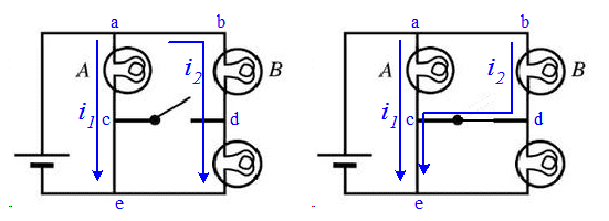

Why does this bulb get brighter after the switch is closed
In summary: And what are your thoughts on that...?In summary, the homework statement was that the answer to the problem is B, bulb B will be brighter than before. TheAttempt at a Solution states that the answer is that the current gets split so that 2/3 I0 goes to the branch with 2 bulbs, since it has twice the resistance of the first branch, and that 1/3 I0 goes to the first branch. My thought was that initially, the current gets split so that 2/3 I0 goes to the branch with 2 bulbs, since it has twice the resistance of the first branch, and that 1/3 I0 goes to the first branch.
alexdr5398
31
None
The answer is B, bulb B will be brighter than before.
My thought was that initially, the current gets split so that 2/3 I0 goes to the branch with 2 bulbs, since it has twice the resistance of the first branch, and that 1/3 I0 goes to the first branch. And when the switch is closed, that initial junction doesn't change, so I picked D.
Can anyone explain where I went wrong?
Your thought on how current was distributed was not correct (edit: study "current division").
"the initial junction doesn't change, so I picked D" requires additional clarification.
Ask yourself what is the voltage across A before and after the switch closure.
Ask yourself what is the voltage across B before and after the switch closure.

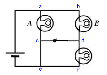

How about when the switch is closed? Let's put some labels on various points of the circuit when the switch is closed:
Can you identify groups of labels that share the same potential? (Let's say the potentials are with respect to the location labeled "e").

Would e, c, d and f have the same potential? And then a and b would also have the same potential?
Yes, that's correct.
So now can you compare the potential differences that appear across the bulbs A and B?

If lightbulbs A and B have the same resistance, wouldn't the potential across ac be equal to the potential across bd?
Yes, but not just because they have the same resistance. You've already ascertained that the potential at a and b is the same, as is the potential at c and d. So regardless of the resistance of the bulbs the potential differences across them must be the same. This is true of any components connected in parallel -- they share the same potential difference if they share the same connection points.

So the potential from a to f will be the same as the potential from b to f, right? So if this is the case then why does bulb B shine brighter than bulb A if both paths have the same potential shared between two bulbs?
Where does it say that bulb B will shine brighter than bulb A?

I don't really know how to talk about it in terms of electric potential, but when the switch is closed, some of the current that was going through path ae now goes through path af instead. So now bulb B gets a greater share of the current going through bf, so it shines brighter.
Is this correct?
Actually, the current flowing through bulb A (path ae) remains the same in both cases. The potential difference is the same in each case: it is the potential difference supplied by the battery since it connects to nodes a and e.
It is the current through bulb B that changes when the switch closes. When the switch is open the path from b to e involves two bulbs in series (the path is bdfe). Two bulbs in series presents more resistance to current flow than one, so the current through that path is less than the current though the bulb A path. When the switch is closed, both paths have just a single bulb across the battery.

Ah okay, I understand now.
So, since path bdce has a lower potential, there will no current going through the third bulb?
Locations have potential. Potential differences drive currents. As you noted previously, when the switch is closed locations c,d,e, and f all have the same potential. So locations d and f have zero potential difference, so there's no potential difference to drive current through the third bulb.
