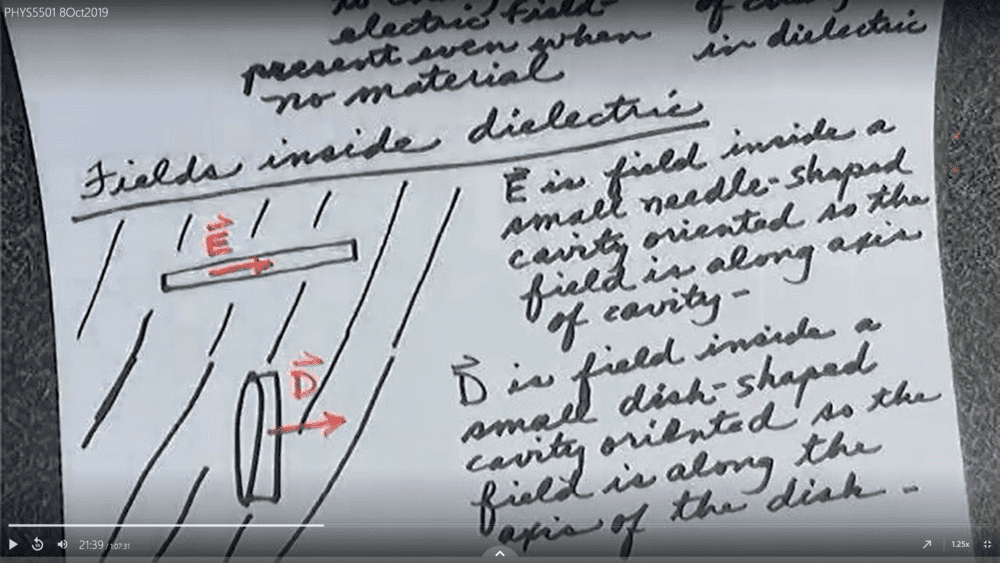

Why does this needle get an E field while this disk gets a D field?
In summary, in reviewing old lectures about polarization, it was discussed that E fields and D fields exist in cavities within a dielectric. When the cavity is turned 90 degrees, the E and D fields also change direction. The equation D = ε0E + P = εE does not seem obvious, but it is explained by the Lorentz-Lorenz formula or Clausius-Mosotti Law. The normal component of D is continuous across a boundary, while the tangential component of E is continuous. However, near the edges of the disk and cylinder, this is not always the case.

So I'm reviewing old lectures to prepare for an exam soon. This is about polarization. E fields, D Fields, etc. My professor labeled this diagram like so. The figures my professor drew are cavities in a dielectric if you can't read her handwriting. However, I can't seem to figure out why the needle gets an E field, and the disk gets an D field. She stated that if we turn the disk cavity 90 degrees to align with the needle, we get an E field.
$$\textbf{D} = \epsilon_0\textbf{E} + \textbf{P} = \epsilon\textbf{E}$$
This equation doesn't make it obvious to me why it is so. The D field is in the direction of the E field, since a D field is a scaled up E field with polarization in mind. My only guess is that the size of the needle being small makes some things negligible.
Thank you for any help you can give!
E and D are different quantities, that have some values in both cavities. If there is vacuum in cavity then: ##\vec{D}=\epsilon_0*\vec{E}##
Have a look at "ELECTRIC FIELD WITHIN A CAVITY INSIDE A DIELECTRIC" (from physicspages.com):

The way I understand this is in terms of boundary conditions. The normal component of ##D## is continuous across a boundary while the tangential ##E## field is continuous across a boundary. Both pictures neglect fringing fields near the disk edge and the cylinder ends. At the center of the disk the normal ##D## is the same inside and outside the cavity. Near the midpoint of the cylinder, it's the tangential ##E## that's the same inside and outside the cavity.
Hm, usually the normal component of ##\vec{D}## is discontinuous with the jump being equal to the surface charge. This follows from the macroscopic Maxwell equation,
$$\vec{\nabla} \cdot \vec{D}=\rho_{\text{free}}.$$
True, within dielectrics usually you have no free charges. I thought you made a general statement about the boundary conditions.
Certainly true that the step in normal ##D## is the surface charge in all cases. For ideal dielectrics, ##\rho_\text{free}=0## so in most cases this step is zero. One may always inject a surface charge onto a boundary but the statement of the problem would need to include this else the boundary value problem isn't specified completely.
