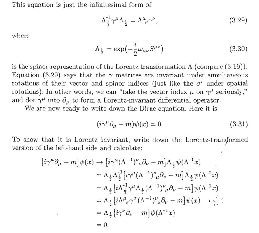

Why does this term transform in this way?
In summary: It doesn't. It only implies that ##(i \gamma^\mu (\Lambda^{-1})^\nu{}_\mu \partial _\nu - m) \Lambda_{\frac{1}{2}} \psi (\Lambda^{-1}x) =...##.

TL;DR Summary
Trying to find out how a certain quantity transforms under Lorentz transformations.
I am trying to understand the last block of equations in the picture (after 3.31). In the first line of that block, he transforms the spinor ##\psi## which I have no problem with. What I have a problem with is the ##\gamma ^{\mu} \partial _{\mu}##. They form a Lorentz scalar, so they should not change as a whole, because ##\gamma ^{\mu} \partial _{\mu} \to \Lambda ^\mu _{\; \alpha} \gamma ^{\alpha} (\Lambda ^{-1}) ^\nu _{\; \mu} \partial _{\nu} = \gamma ^{\mu} \partial _{\mu} ##. Instead, he only transforms the derivative in this way: ##\partial _{\mu} \to (\Lambda ^{-1}) ^\nu _{\; \mu} \partial _{\nu} ##. My question is why doesn't he transform the gamma matrices as well? They have a Lorentz index too.
Even though the (generally contravariant) index of the gammas runs from 0 to 3 in that summation, the set of 4 gammas in special relativity do not transform as the components of a 4-vector, they are constant matrices (particular forms such as chiral/Weyl, Dirac, Majorana). So no need to put an extra Lorentz transformation there.
Thank you, that explains it. I have a second question. How is ##\gamma ^\mu \partial _\mu## Lorentz invariant? It's transformation is
##\gamma ^{\mu} \partial _{\mu} \to\gamma ^{\mu} (\Lambda ^{-1}) ^\nu _{\; \mu} \partial _{\nu} \neq \gamma ^{\mu} \partial _{\mu} ## since the matrix ##\Lambda ^{-1}## is not a Kronecker delta in general.
It isn't. What is invariant is ##\gamma^\mu \partial_\mu \psi##, where ##\psi## is a spinor. The spinor transforms in just the right way to keep that expression invariant even though ##\partial_\mu## transforms as well.
Thank you so much. I got confused because that page says it is a Lorentz invariant differential operator, but it is the operator acting on the spinor that remains invariant as a whole.
Yes, that's sloppy since it's only true when it's operating on a spinor (probably the textbook writers assumed that would be understood since that section is talking about spinors). More generally, any expression involving the gamma matrices that looks Lorentz invariant based on its indices, will only give a Lorentz invariant quantity when it's operating on a spinor (where for something like ##\gamma^\mu A_\mu##, which occurs in the QED Lagrangian, "operating on" means "multiplying to the right").

PeterDonis said:
Yes, that's sloppy since it's only true when it's operating on a spinor. More generally, any expression involving the gamma matrices that looks Lorentz invariant based on its indices, will only give a Lorentz invariant quantity when it's operating on a spinor (where for something like ##\gamma^\mu A_\mu##, which occurs in the QED Lagrangian, "operating on" means "multiplying to the right").
In the third to last line at the bottom of the page, how could we change the argument of ##\psi## from ##\Lambda ^{-1} x## to ##x##?
I think that's a typo since it goes back to being ##\psi(\Lambda ^{-1} x)## in the next line.

I feel like I'm missing something important (perhaps because I am a beginner and I'm self studying this), but if we have an equation ##(i \gamma ^\mu \partial _\mu - m) \psi (x) = 0##, why does this imply that ##(i \gamma ^\mu \partial _\mu - m) \psi (\Lambda ^{-1}x) = 0##?
For example, if we are given that this is a fact ##(\partial _x + c) f(x) = 0 ## (where c is a constant and f is a function of x), then it does not imply ##(\partial _x + c) f(2x) = 0 ## because ##(\partial _x + c) f(2x) = 2 \frac{\partial f(2x)}{\partial (2x)} + cf(2x) ## after renaming the dummy variable x we get ##2 \frac{\partial f(x)}{\partial x} + cf(x)## which we cannot conclude is zero.
MichaelJ12 said:
if we have an equation ##(i \gamma^\mu \partial _\mu - m) \psi (x) = 0##, why does this imply that ##(i \gamma^\mu \partial _\mu - m) \psi (\Lambda^{-1}x) = 0##?
It doesn't. It only implies that ##(i \gamma^\mu (\Lambda^{-1})^\nu{}_\mu \partial _\nu - m) \Lambda_{\frac{1}{2}} \psi (\Lambda^{-1}x) = 0##.

How did we conclude that the second to last equation on the page is zero?
You mean this?
\Lambda_{\frac{1}{2}} (i \gamma^\nu \partial _\nu - m) \psi (\Lambda^{-1}x) = 0
The ##\Lambda_{\frac{1}{2}}## commutes with everything inside the parentheses, so we have
(i \gamma^\nu \partial _\nu - m) \Lambda_{\frac{1}{2}} \psi (\Lambda^{-1}x) = 0
And we have ##\Lambda_{\frac{1}{2}} \psi (\Lambda^{-1}x) = \psi(x)## because that's how spinors transform, so we just have the original Dirac equation back again.

We know that ##\psi(x) \to \Lambda_{\frac{1}{2}} \psi (\Lambda^{-1}x)##, but why can we replace the ##\to## with an ##=## and say ##\psi(x) = \Lambda_{\frac{1}{2}} \psi (\Lambda^{-1}x)##?
The ##\to## represents what happens after a Lorentz transformation, right? How can we equate the field before the transformation and after the transformation?
Because the Lorentz transformation is invertible.

MichaelJ12 said:
Throw away this textbook or notes that you are using. To prove that the Dirac equation is Lorentz covariant, you only need the following transformation laws:
[tex]x^{\mu} \to \bar{x}^{\mu} = \Lambda^{\mu}{}_{\nu} \ x^{\nu} , \ \ \ \ \ \ \ \ \ \ \ \ \ \ \ \ \ \ (1)[/tex][tex]\psi (x) \to \psi^{\prime} (\bar{x}) = D(\Lambda) \psi (x) . \ \ \ \ \ (2)[/tex] I use [itex]D(\Lambda)[/itex] instead of the ugly [itex]\Lambda_{\frac{1}{2}}[/itex] notation. So the question of Lorentz covariance is the following: we would like to find a transformation matrix [itex]D(\Lambda)[/itex] such that the Dirac equation retains it’s form in the [itex]\bar{x}[/itex]-system.
Okay, start from the Dirac equation in the x-system: [tex]i \gamma^{\nu} \frac{\partial}{\partial x^{\nu}} \psi (x) - m \psi (x) = 0 .[/tex] Multiply this from the left by [itex]D[/itex] and insert the identity matrix [itex]D^{-1}D[/itex] as follows [tex]i D \gamma^{\nu} \left( D^{-1}D \right) \frac{\partial}{\partial x^{\nu}} \psi (x) - m D \psi (x) = 0 . \ \ \ \ \ \ \ \ \ \ \ \ \ (3)[/tex] Now, the chain rule and (1) give you [tex]\frac{\partial}{\partial x^{\nu}} =\frac{\partial \bar{x}^{\mu}}{\partial x^{\nu}} \frac{\partial}{\partial \bar{x}^{\mu}} = \Lambda^{\mu}{}_{\nu} \frac{\partial}{\partial \bar{x}^{\mu}} . \ \ \ \ \ \ \ \ \ \ \ \ \ \ \ \ (4)[/tex] Finally, substitute (2) and (4) in (3): [tex]i \left( D \gamma^{\nu} D^{-1} \Lambda^{\mu}{}_{\nu}\right) \frac{\partial}{\partial \bar{x}^{\mu}} \psi^{\prime}(\bar{x}) - m \psi^{\prime}(\bar{x}) = 0 .[/tex] Thus, the Dirac equation will have the same form in the [itex]\bar{x}[/itex]-system (i.e., Lorentz covariant) if and only if the matrix [itex]D[/itex] satisfies [tex]D \gamma^{\nu} D^{-1} \Lambda^{\mu}{}_{\nu} = \gamma^{\mu} ,[/tex] or [tex]D^{-1} \gamma^{\mu}D = \Lambda^{\mu}{}_{\nu} \gamma^{\nu} .[/tex]
Regarding the business of [itex]\psi ( \Lambda^{-1}x )[/itex] in the transformation law: From (1), you have [itex]x = \Lambda^{-1} \bar{x}[/itex]. Substituting this in the transformation law (2), you get [itex]\psi^{\prime} (\bar{x}) = D(\Lambda) \psi (\Lambda^{-1}\bar{x})[/itex]. Now you can drop the bars from the coordinates, i.e., rename your coordinates as [itex]x[/itex] to obtain [itex]\psi^{\prime} (x) = D (\Lambda) \psi ( \Lambda^{-1}x)[/itex].

No, [itex]\Lambda_{\frac{1}{2}}[/itex] does not commute with [itex]\gamma^{\nu}[/itex].

Just one little point: I want to understand why you say that ##\psi (x) \to \psi^{\prime} (\bar{x})## instead of ##\psi (x) \to \psi^{\prime} (x)##.
I considered two coordinate systems (two observers) looking at the same point [itex]P[/itex] which has two different coordinate values [itex]x[/itex] and [itex]\bar{x} = \Lambda x[/itex] as seen by the two observers [itex](O , \psi )[/itex] and [itex](O^{\prime} , \psi^{\prime})[/itex] respectively. So, [itex]\psi (x) \to \psi^{\prime} (\bar{x})[/itex] simply means [itex]\psi (P) \to \psi^{\prime} (P)[/itex].
This is the same as the above provided you understand it to mean [tex]\psi (P) \to \psi^{\prime}(P) \equiv (D \psi )(P) = D \left( \psi (P)\right) .[/tex]
No, [itex]\gamma^{\mu}\partial_{\mu}\psi[/itex] is not invariant. If it was you would not be able to add the non-invariant (spinor) term [itex]-m \psi[/itex] to it and the Dirac equation would make no sense. Indeed, it transforms exactly like [itex]\psi[/itex]: [tex]\gamma^{\mu}\partial_{\mu} \psi \to D(\Lambda ) \ \gamma^{\nu}\partial_{\nu}\psi .[/tex]
samalkhaiat said:
it transforms exactly like ##\psi##:
That is what I meant to convey, but you're right, "invariant" is not the right word to convey that.
The right word is "covariant". A Dirac spinor field realizes the Poincare symmetry in a specific way (i.e., a representation of the Poincare group) and thus transforms under Lorentz transformations which are a subgroup of the Poincare group in a specific covariant way.
After quantizing the Dirac field you have a local unitary realization of the Poincare group, allowing to establish a valid special-relativistic QT of a spin-1/2 fermion and its anti-particle, which latter must be necessarily occur if you want a local realization of the Poincare group.
