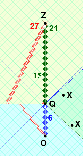

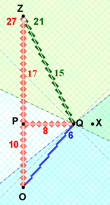

To drive home that the non-inertial traveler is not equivalent to the inertial twin,
I think it's useful to consider the traveler with an asymmetric trip (with numbers chosen to allow calculations with fractions).
While this diagram for inertial twin OPZ
can be thought of as "a splicing together
of the diagrams for OP (using simultaneity according to OP)
and for PZ (using simultaneity according to OP)",
the same can't be said for OQZ.
In accord with what @Orodruin and @Dale said, the non-inertial traveler OQZ
has a very different looking "[attempted] spacetime diagram". A portion of OPZ is missing in OQZ's diagram.
  • a portion of OPZ's worldline is missing and OPZ is discontinuous.
    In fact, event P and other events in the white region are missing.
    The attempted spacetime diagram is incomplete... events are missing.
    (This doesn't happen for inertial observers.)
  • Event X and other events in the green region appear twice.
No Lorentz transformation will straighten out the kink at Q.
The takeaway message is
"Being able-to-be-at-rest" [itex] \neq [/itex] "Being inertial".
Likes ersa17

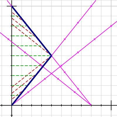

I'll go out on a limb and claim that, for the moving observer, there is no single instant in which the process assigns multiple coordinates to a single event. At different instants, an event will have different coordinates, but never simultaneously for the moving observer (unless you allow for instantaneous acceleration).
But perhaps you can show me what you mean with a diagram. I can't picture it.

Draw a curved worldline on a Minkowski diagram. Draw a line perpendicular to that line at some event (in the Minkowski sense of perpendicular), and that line is the locus of events sharing a t-coordinate value using your methodology. Now draw another perpendicular line at another event on the worldline. That line is also the locus of events sharing a t-coordinate, but a different value from the first line.
Unless the velocity of the worldline is equal at the two events from which you drew perpendiculars, those lines are not parallel. Thus they intersect at some event - and you have assigned two different t-coordinates to this event. For the special case of constant acceleration this event is the intersection of the Rindler horizon and anti-horizon.
For illustrations see figure 1 (instantaneous turnaround) and 2 (smooth turnaround) in Dolby and Gull.

Sure, that's obvious. But those are two different points in time for the observer whose worldline you are drawing tangents to. There is no single instant for that observer at which an event has two coordinates.
On the other hand, if you allow for instantaneous acceleration, there is one instant in which the observer would have two valid and different sets of coordinates for some event.
You are wrong. The moving observer's lines of constant time, according to your definition, will inevitably cross at some distance "below" him (i.e., in the direction opposite to the direction in which he is accelerating), which means his coordinate chart will assign multiple values of his ##t## coordinate to the same event. This is a well-known limitation of the method you are describing.
Likes Freixas and vanhees71
Thanks, Peter. I'm not sure why, but I never got notified of your reply and I only drop into this group occasionally (oddly, I just received a notification for a new thread that I had never seen or interacted with--weird).
We'll take it as given that I'm wrong. Could you help me see where I went wrong? Here's how I visualize the problem:
The units are light years (x) and years (t). The constant acceleration for the moving observer is .01 Earth gravities. The cyan axes show the Instantaneous Moving Frame (IMF) at rest time 20 years. For the moving observer, it appears to me that every event has a single coordinate at this instant in time. In addition, all events have coordinates--there are no events for which a coordinate cannot be calculated.
There is nothing special about this point in time, so I generalized this to any instant and made the claim that you point out as being wrong.
Lines of constant time, to the moving observer, would be lines parallel to his x' axis. Parallel lines being what they are, I can't see how they cross at some distance "below" the observer.
Perhaps there is something wrong with the diagram. Here's how I drew it: The t' axis's angle is calculated as tangent to the moving observer's world line. I have formulas that tell me the instantaneous velocity at any point of the moving observer's world line. Once I know the velocity, the units for t' and x' can be calculated. This determines the origin of the t' axis. The velocity also determines the angle of the x' axis.
What you've drawn in cyan is the instantaneous inertial rest frame of an object on the red worldline. That's fine. And you can draw the instantaneous inertial rest frame of the object at any time. However each of these cover all of spacetime. If you want to "stitch them together" into one coordinate system you need some rule to describe which bit of spacetime you are going to cover with which frame. The naive way of doing it leads to the frames all overlapping at the focus of the hyperbola, which means that the observer applies multiple coordinates to one event. Non-naive ways of doing it don't really fit the notion of "the perspective of the accelerating observer".
Likes Freixas and PeterDonis
Thanks, Ibix!
It never occurred to me that one would want to "stitch together" the various IMFs. But I can see that if I were to try to switch the two observers in my diagram, I would want some single coordinate system. (There appears to be an alternative approach on the Minkowski Spacetime Diagram Wikipedia page [see "Spacetime diagram of an accelerating observer in special relativity"] which makes more sense to me: you fix the accelerating observer at (x, t) = (0,0) and animate the changing coordinate system relative to the observer at each point in time.)
Let's go back to post #10. If there are multiple ways one might stitch together all the IMFs into a single coordinate system, is the method used by robphy the "approved" method? When he claimed that some events have multiple coordinates and some have none, is this claim an artifact of an arbitrary choice of stitching (i.e. I could choose some other stitching method in which his claims would be incorrect) or is this the method all physicists would use?
Let me try to simplify by re-using an old diagram I had lying around for the twins paradox:
This example assumes a single instantaneous acceleration change, so there are just two frames to consider. If we just overlay the two frames over each other I'm assuming this is the "naive" method), every event has two coordinates and no event has missing coordinates. Is there a commonly accepted method of creating a single coordinate system for these two frames?
No. There is no standard method for forming a non inertial frame. That is part of the problem.
My preferred approach is radar coordinates. This avoids the overlaps and gaps of the naive approach, and it is the only convention I know that respects the second postulate.

Perhaps you can help clarify post #10 for me. It appears to me to propose a mapping and then lists some problems that the mapping reveals. Are the problems universal (missing worldlines and events, events appearing twice) or are these more a reflection of the choice of mapping?
While I would love to see your radar version of the twins paradox diagram I posted, I know that's asking a lot. I looked up radar coordinates, but it would be really helpful to see the diagram that I posted converted to your preferred approach by someone who actually knows what he is doing.
