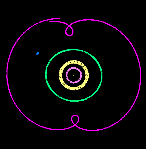

There's a big difference between ratios that are almost integers and ratios that are integers. And ratios that are integers aren't necessarily integers at any given moment, but over long periods of time, they average into integers.
Take a look at the two illustrations. The first one shows the Sun, Venus and Earth in what last month's Sky & Telescope magazine called a "Kepler's Pretzel". Notice how the top loop is a little thicker than the rest. That's because I let it run one loop beyond a complete cycle. After Venus traced its 5 loops, it began to almost repeat the pattern. But it is not repeating the pattern, and ultimately each loop will advance upon and pass the loop ahead of it.
The second illustration is an animated GIF of Neptune and Pluto in a rotating frame. Neptune is the almost-stationary blue dot. Pluto's orbit is the purple path. It shows a completely different story for Neptune and Pluto. At any given moment, their periods are not exactly 3:2. So Pluto’s perihelion advanced upon Neptune’s position. But when Pluto's perihelion advances too close to Neptune, orbital energy is exchanged which ever so slightly changes Pluto's period. This prevents it from coming any closer to Neptune. Pluto's perihelion then spends thousands of years advancing in the opposite direction until it encounters Neptune from the other side. Then the exchange of energy happens again and repels Pluto's perihelion once again, preventing it from ever coming close to Neptune.
In the Earth/Venus situation, no such mechanism exists. So their periods are just coincidentally a ratio of approximate integers. But the Neptune/Pluto situation corrects itself when it tries to go astray, ensuring that its ratio averages Exactly 3:2 over long periods of time.
As an analogy, picture 2 cars driving down the freeway at almost the same speed. They appear to be in a 1:1 ratio with each other. For every 1 mile the first car drives, the second car also drives 1 mile. But the drivers are strangers to each other. They are just coincidentally driving at about the exact same speed, and in the same direction. After 100's of miles they are likely to be quite a distance from each other, especially if one stops for gas, or a rest, etc. It becomes obvious that their 1:1 resonance isn't exactly 1:1.
Now imagine 2 drivers that know each other. They are driving together to the same destination. They also appear to be in a 1:1 resonance. But not only do they have similar speeds, but when their distances get too great, they correct for that to maintain an acceptable spacing. If one has to stop for gas, and the other one doesn't need gas, he pulls over anyway. After thousands miles, they are still within a few hundred yards of each other. Although at any given moment their speeds might not be exactly the same, their speeds, and therefore their resonance averages exactly 1:1 no matter how far they drive.

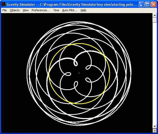

Regarding the Kepler's pretzel, are the loops supposed to represent the rotation of Venus, or the crazy orbital path of some small object? Also, I downloaded gravity simulator, but couldn't get the time step command to work. Any suggestions?
Bottom line is that there are way too many cooincidences--and this requires a special explanation. It's like in biology. A watch implies a watchmaker, or at least natural selection. Rather than trying to derive Venus's rotation from first principles, a better approach is to assume that the rotation is there because it is a good design for the intrinsic value of least action. One's task is then to reverse engineer this design--a top down approach. Physical science can benefit from a healthy dose of biology-style teleology.
WarrenPlatts said:
...Regarding the Kepler's pretzel, are the loops supposed to represent the rotation of Venus, or the crazy orbital path of some small object? Also, I downloaded gravity simulator, but couldn't get the time step command to work. Any suggestions?...
Sorry, I didn't explain the Kepler's Pretzel well. This shows the motion of Venus in an Earth-centered universe. It doesn't represent Venus' rotation. The dot in the middle represents Earth, the yellow circle represents the path of the Sun around Earth, and the white pretzel represents the path of Venus around the Earth. No wonder this model drove the ancient people crazy! In a day and age when we know that Earth is not in the center, Kepler's Pretzel still helps to illustrate things.
Each of those loops represents a Venus inferior conjunction, when Venus makes a close pass to Earth. They happen about every 1.6 years. The next one will happen in January. After every group of 5, the pattern repeats itself. That's why transits of Venus happen in pairs, spaced 8 years apart (1.6 * 5 = 8).
Mars is another interesting object to view in a Kepler's Pretzel. It is currently at a close point to Earth, making a loop. If you run time backwards, you can see that the loop it made 2 years ago was even closer. Hence, the 2003 opposition was the closest in thousands of years. Run time forwards and you will see that it will not loop as close to Earth as it does in 2005 until the year 2018.
To make a Kepler's Pretzel in Gravity Simulator, open the simulation "onlyplanets.gsim". If the user controls are not visible on the screen, press F8 or F9. Then choose Earth as the "Focus Object". Make sure your trails are turned on (The T button), and increase the Time Step. There's a + button on the Time Step control. But don't exceed 16384 or you'll be introducing math errors into the simulation, and your planets will wander from their true positions.
