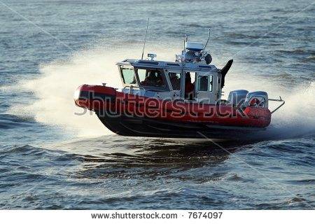

If you are swimming at the surface, you generate waves. Ignoring the "splashing" effect of arms or legs entering or leaving the water, there is a large increase in the resistance force when an object reaches a critical speed which depends mainly on its length, because it is effectively traveling "uphill" trying to climb up the bow wave it generates in front of it. A boat with a high power engine, or a sailing boat in a strong wind, can get "on top of" its bow wave and is then effectively traveling down hill with the front of the hull completely out of the water, until it has to slow down.
ck-photo-speedboat-cruising-the-sea-hydroplaning-at-high-speed-identifying-marks-removed-7674097.jpg
Apparently ducklings can do this to escape from predators quickly, even if human swimmers can't. http://jeb.biologists.org/content/198/7/1567.full.pdf

Loons ((the state birds of Minnesota (US)) are really good at that! I don't know what their favorite fish is, (too personal to ask a Loon) - read my intro for reference to that one! - but I think this wave interference thing is what Kaustubh sri was speaking of. :-)
