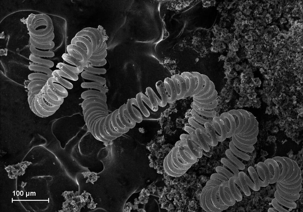

If you look at a filament closely it looks like a helix, but under a microscope it is a "coiled coil".
Дагесян Саркис Арменакович, Wikipedia
For a 60-watt 120-volt lamp, the uncoiled length of the tungsten filament is usually 580 millimetres (22.8 in),[61] and the filament diameter is 0.046 millimetres (0.0018 in).
The cold resistance of tungsten-filament lamps is about 1/15 the resistance when operating. For example, a 100-watt, 120-volt lamp has a resistance of 144 ohms when lit, but the cold resistance is much lower (about 9.5 ohms).
