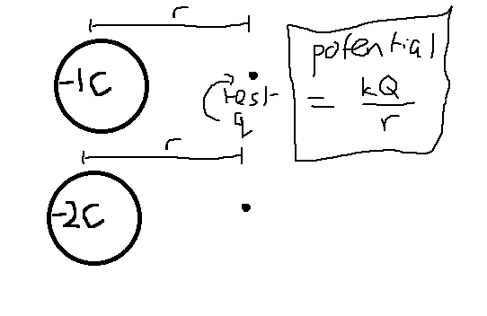

The way I'm visualising the electrons produced on the electrodes is as spherical concentrations of charge; the potential is given by kQ/r where Q is the charge on the electrode and r is the distance to the electrode; as I understand it the amount of charge on the electrode Q is what matters to the potential, not the charge density, so wouldn't twice as much charge on the electrode produce a potential of double the magnitude?
Am I using the wrong expression for electrical potential (V= kQ/r)? If not I can't understand why a higher Q (charge on the electrode) would not provide a higher V.

You're indeed using using the wrong expression. A battery would be more like a parallel plate capacitor, and the capacitance would rise if you made the plates bigger, so it could still have the same potential, even with a bigger charge.
No matter what the geometry of the plates is however, the potential will be the same anyway, because the reaction will run until the potential produced by the charge on the plates is equal to the chemical potential of the battery.
The only thing that can affect the chemical reaction somewhat is the concentration of the reagents, but the concentration of the metal and the electrons is really constant here because:
- if you insert more metal in the electrolyte, it will touch more electrolyte as well
- the extra amount of electrons because of the charge on the plate is tiny compared to the total amount of conduction electrons.
The only concentration that can affect the reaction rate is that of Mg2+. If there's a lot of it around the cell voltage wil be lower. Look up the Nernst equation.

AS @willem2 has stated you are using the wrong formula to try and analyze a battery. The potential difference between the electrodes exists like the potential difference between the top of a hill and the bottom in a gravitational field. But the actual description of the forces as a body rolls down the hill is not given simply by the fundamental potential expression GM/r as it rolls, bounces etc down the hill. although the gain in energy (neglecting friction of course) is easily understood.
The other point is that for a battery the net charge of the system is zero right? for every electron there is a proton. So a battery is not like a capacitor. What is happening ( and this explanation is a bit clumsy ) is that electron must be freed from one electrode to be "pulled" to the other and absorbed but the pull is not just an easily described electric field between the two electrodes although we know there is some field at every point in the system to move the electrons around the circuit. It turns out that the actual emf of a cell is different than one would expect from the electrochemical series differences. On discharge a certain amount of energy is used or liberated in purely chemical processes. The microscopic description is complex and needs thermodynamics to work through the process. As often happen a seemingly simple question has a very involved explanation.
