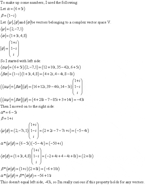

Hey guys I'm new here and I've been using MathType for all on-screen math. For some reason PF doesn't recognize the built-in Dirac's bra-ket notation. (i.e. <[itex]\psi[/itex]|) So I've included my equations and solution in the format of images, hopefully it isn't a problem.
Proof that
All other properties of inner product.
Proof that
