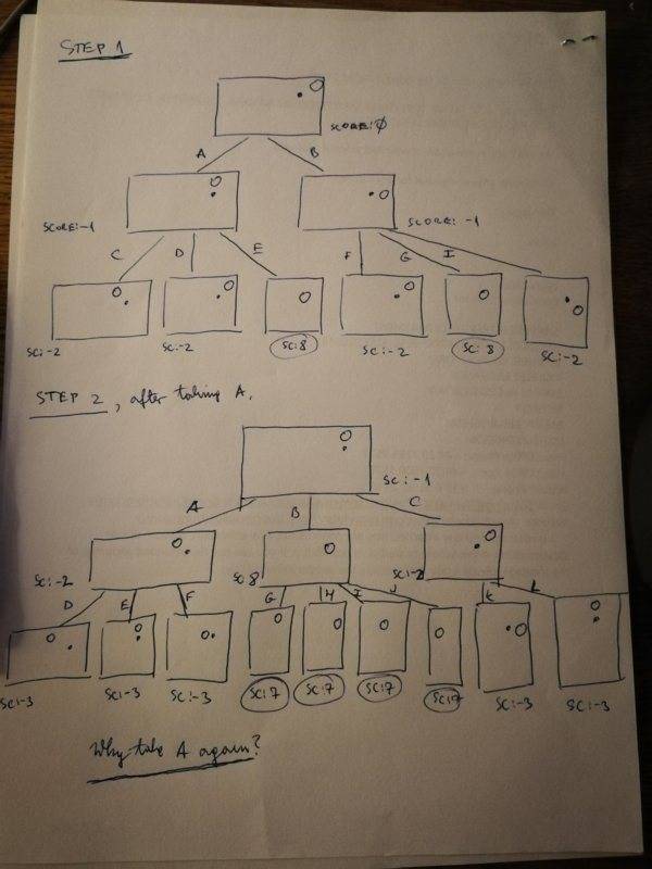

I've been following Berkeley's AI course, and I'm a little stuck. In this video , at 1 hour, 11 minutes, and 55 seconds, there's a short simulation of what they claim to be a depth-2 minimax algorithm applied to the Pac-Man scenario with two dots. Pac-Man begins in the corner.
The video shows Pac-Man moving left so that it's above the dot, and then makes another left. Now, if you watch the video, that exact scenario isn't explained; the subsequent one is (a minute after the simulation in the video). I sketched the first simulation in the similar manner, but I simply cannot get a tree that's 2 levels deep that would yield the action of going to the left. (The action of going to the right afterwards is alright but not the next one where it goes left, and so on.)
I assume the cost is -1 for a single step, and +10 for eating a dot. (The -1 still applies.)
Once Pac-Man's above the dot, there are three possible states it can enter: it can (1) eat the dot (go down), (2) go left, or (3) go right. The first choice gets Pac-Man +10 points with -1 for the step. The other two only cost Pac-Man -1 point. Since we're talking about a depth-2 minimax, we include the subsequent scenarios as well.
  1. From the first one we get 4 possible scenarios, left, right, down, and up. All of these are away from the previously eaten dot (so no extra points, only the -1 for the step).
  2. From the second one it can go down, left, and right, and again, we get nothing but lose that one point.
  3. From the third one it can go left and down – same situation, no extra points.
From the above it seems the only rational thing it can do is go down first (option (1)), and then wherever because everything else results in a change of score of -2, while the first option together with any of the four ones it can subsequently make yield a total of +8. (+8 > -2)
Please, could someone explain why it doesn't eat the dot?

I'm not familiar with this type of logic, but it appears the issue is considering that being adjacent to the dot gets the same score as actually eating the dot. It's also not clear what the logic is in the "replanning agent". Is the "agent" aware of every dot's position or only those with in 3 steps?
I also question the logic behind using a depth of 2 tree, when considering 3 or more step cases (where the dot doesn't get eaten until the 3rd or later step, with a corresponding score of 7 or less.
I think the goal of this was to show an issue with "replanning agents", but the example seems like a poor choice.

Thank you for your reply. Do you see the example the professor shows next, where there's a very simple one-row "game space" (this blue environment Pacman moves in) of only a few possible spaces, with a dot in each corner, left and right.
245379
So, this is a different scenario where at the beginning Pacman plans 2 levels ahead. It's obvious here that it can happen that it simply follows the first right arm of the tree, but then it replans, which means it gets this same tree (with subtrees symmetrically flipped):
245381
So now because the minimax algorithm gives it the same values for both subtrees, it can again reasonably take the left subtree. And so on, it paces back and forth, never eating the dot.In the situation I described above, this doesn't happen. I have sketched the tree on a paper for each step of the planning.
245382
So, it first plans and takes the A route (it could've taken B just as well), which puts it above the dot. Then it plans again, and in step 2 it should take B because it can get the most out of it.
Yes, it can see the other dot, and I suspect there might be something going on with it taking it into account, but as shown in the other example, it doesn't seem like it considers it at all; only the score.
Yes, this is to show that replanning can sometimes lead to starvation (or thrashing, or whatever it's called), but I'm just not sure how it works on that particular example.

I'm wondering about possible "tree pruning" (I'm only aware of this because of chess programs). Possible options:
Score a path that eats a dot sooner higher than one that eats a dot later.
Eliminate any move that results in a mirror image of the current state (no progress).
Eliminate any path with any leaf that results in the original state or a mirror image of the original state (potential no progress).
