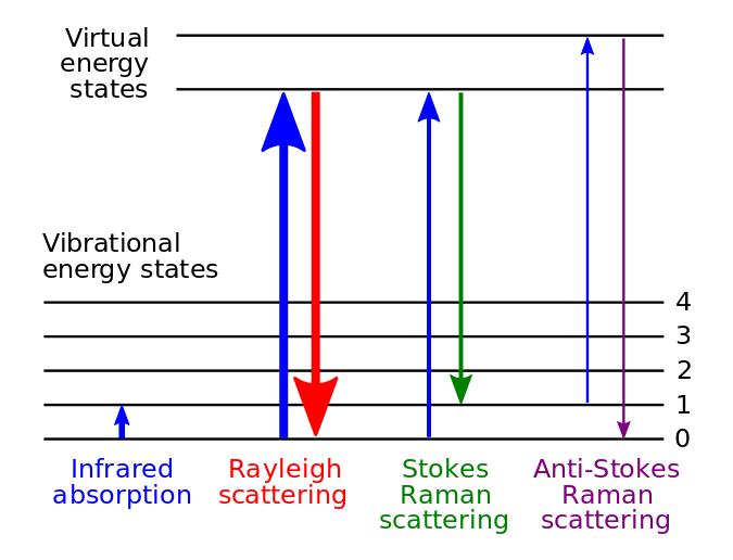

Why? Please elaborate.Huygens principle states that "each point on wavefront act as a fresh source of distribution of light". Are those "fresh sources" introducing random phase delays?
  • #33
When an atom goes into an excited state, there is a random element in the time it takes to re-emit its photon so the coherence is destroyed. The only time this effect doesn't happen is in a laser, when there is stimulated emission. But that only happens (to any significant degree) when you have a Population Inversion. It's a long time since I learned this but it only happens under the 'right conditions, only in some molecules and when vast numbers of the atoms are in the excited state.
So this doesn't constitute Huygens sources, which is when the whole wave interacts with the bulk of the substance, rather than with individual atoms. These Huygens sources are not 'real particles' but a mathematical construct, invented before Calculus was available for diffraction calculations and are much the same thing (afaiaa).

True, but what if the atom/molecule goes into a virtual state (more probable than into an excited state, when the material is transparent ...)? In this case it is not a real absorption but a failed one, always and promptly followed by the re-emission ... It would be almost like with the Huygens sources ...
