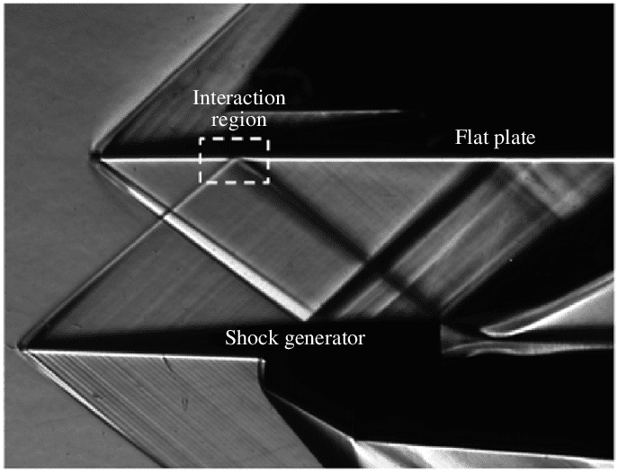

bo reddude said:
... a sonic boom, or constant sonic boom, or something?
If you had a constant supersonic wind, you would have shockwaves at fixed locations, like in a supersonic wind tunnel. So you wouldn't hear a distinct boom, unless you pass quickly though the shockwaves (e.g. being blown by the wind):
From: https://www.researchgate.net/figure/Schlieren-visualization-of-the-wind-tunnel-configuration-M-17-Re-35-10-6-m-1_fig1_324223394
