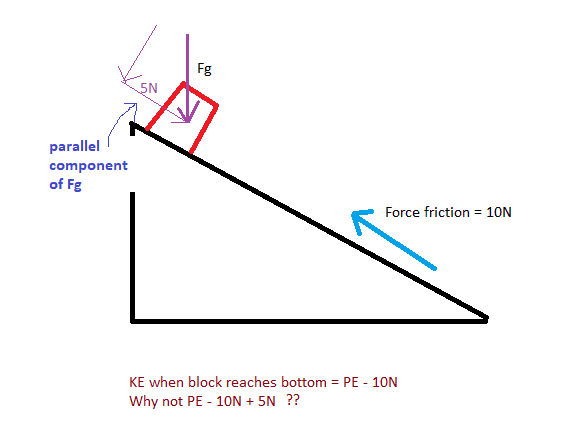

For physics questions where, say, a block is at the top of a declined ramp, how come the KE once the block reaches the bottom is determined by:
KE = initial PE - any energy lost due to friction
rather than:
KE = initial PE - any energy lost due to friction + any work done by the vector component of gravity that is parallel to the direction vector of the object.
244340
The PE is the same as the work done by the vector component of gravity that is parallel to the direction vector of the object.

gazeem said:
Summary: For physics questions where, say, a block is at the top of a declined ramp, how come the KE once the block reaches the bottom is determined by:
Or more generally:
KE = (initial PE - final PE) - any energy lost due to friction
gazeem said:
rather than:
Beacuse that would be double accounting for the work done by gravity, which is already included as:
Likes gazeem
Ah okay I see. Thank you both so much for your responses, makes more sense now.
Likes Dale
It would be a good exercise to solve the problem both ways: 1) using PE and 2) using W = Fd for the gravitational force down the slope.
This may give you an insight into why physically and mathematically they give the same result.
Likes gazeem and russ_watters
