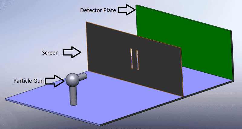

Why doesn't the plate interact with the particle in double slit?
In summary, the particle passes through the slit but is absorbed or reflected by the screen, so we don't observe it. The particle can only be observed if it doesn't interact with the screen, and this is because the detector plate is classical.
platosuniverse
29
When particles are shot at the plate/screen in the double slit experiment, why doesn't the particles interact with the screen? Shouldn't the plate act as an observer and "collapse" the wave function into one or the other slit? Why does it take a measuring apparatus to know which slit the particle went through? Here's a pic:
The screen is a classical object so shouldn't the particles interact with the screen? The detector plate is classical. It's said Schrodinger's cat will end up in one state or the other because of decoherence. Why doesn't that apply to the screen/plate and the detector plate?
So if you had the cat in the box, wouldn't it have to be in both states like the screen/plate until a measuring apparatus or human measured it? Let's replace the cat with a tennis ball. If the atom decays, the ball explodes but if it doesn't the ball is fine.
Without a measuring device, doesn't the ball have to be in two states until a measurement occurs? The screen/plate isn't in a single state. It's not particle through left slit or particle through right slit until measured.
So why would a cat be dead/alive or the tennis ball be exploded/not exploded until a measuring apparatus measured it? The wave function must contain both states of the cat/ball until it's measured. There may be a single cat/ball in the box but do they have an objective existence until a measurement occurs?
Everything that hits the plate is absorbed (or reflected) and doesn't matter for what happens behind the slits.
Many of them do; as @mfb says, we don't observe those particles because they get absorbed or reflected by the screen and never reach the detector. The only particles we observe at the detector are the ones that don't interact with the screen because they go through the slits.

If we rephrase this question to apply to a double slit experiment done with weak enough light that quantum effects become important, then the answer is that it does--but that decoherence corresponds to photons that don't get observed, because they hit the walls of the box instead of going through the slits and getting observed at the detector.
The particle either gets absorbed by the screen (with probability ##p##) or passes through the slit (with probability ##1-p##). In the experiment one emits many particles, some which get absorbed while others pass through the slit. In the further analysis of the experiment one ignores the particles which are absorbed by the screen (because they are not interesting) and concentrates only on particles that passed through the slit.

You're missing the point. When you talk about particles being absorbed by the screen, these are different particles from the ones that are detected at the detector. For a particle that's absorbed by the screen, the screen collapses the particle. We just don't observe it because the screen is not designed that way. If you wanted to directly observe the particles that hit the screen, you could make the screen out of a material similar to what the detector is made out of, so that particles that hit the screen showed a flash of light, the same way particles that hit the detector do. Then you would find that every time the source emits a particle, you either see a flash on the screen, or a flash on the detector, with relative probabilities ##p## and ##1 - p##.

I'm not sure what you mean. If the screen doesn't collapse particles that hit it, it's not a screen. The whole point of the double slit experiment is to have a screen with two slits, where "screen" means "collapses particles that hit it", and "slits" means "whatever isn't screen". These are the functional specifications of the experiment, not things you can adjust at will.
You could certainly run an experiment where you had a "screen" made out of something that didn't collapse particles, but then it wouldn't be a double slit experiment. It would be some other kind of experiment (I can't say what kind because I would need a much more specific description of what you wanted this modified "screen" to actually do).

Well, suppose you're running this experiment, and without the screen with the double slit in place, you're detecting 100 particles per minute. You put the screen in, and now you're getting 1 particle per minute. Most are being absorbed by the screen, it seems. Suppose you don't like that, and want to increase the number getting through, besides doing things like adjusting the beam, is one option to switch the material that the double slit is made from to another material?
Then you don't like running double slit experiments. :wink:
The point of a double slit experiment is to see the interference pattern. To see that, the size of the slits has to be small in comparison with the size of the screen; in other words, there cannot be a very large percentage of area which is slit and not screen. That means it's unavoidable to have only a small percentage of all the particles go through the slits.

So I cut two narrow slits in a dark plate (something that readily absorbs photons) and put it in front of my low intensity photon beam, and the number of particles hitting the detector per minute drops from 100 per minute to 1 per minute. Then I cut two identical slits in, say, a piece of polished silver (something that readily reflects photons), and put it in front, I will find the same drop in the number hitting the detector, all other things (beam width, position of slits. etc.) being equal?
Yes.
