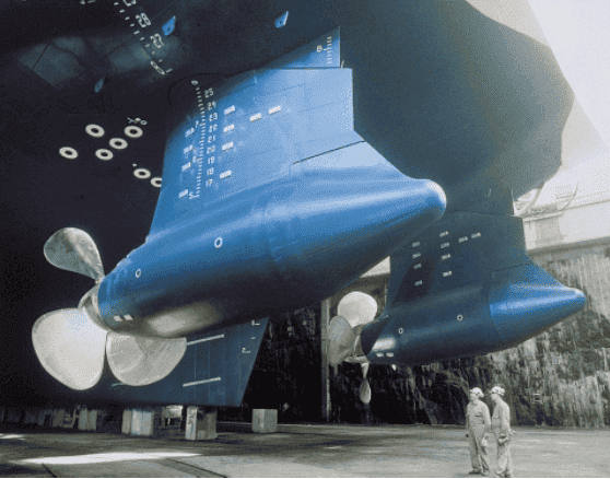

Have a look at this post. It was inspired by this thread.
https://www.physicsforums.com/threads/remarkable-new-marine-propulsion-systems.972646/#post-6186452
