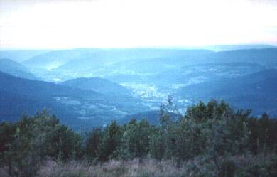

My question is that if particles ( gas molecules) scatters blue light, why don't we see every thing(empty space between my room window and the tree in the lawn) blue, ( after all it is atmosphere only between my window and tree) rather the atmosphere in between appear some what pale yellow. Why only atmosphere of above height(I.e. Sky) appear blue.
There is not enough air on this short distance for the effect to be noticeable. Distant mountains appear blue.

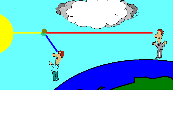

Try this:
http://math.ucr.edu/home/baez/physics/General/BlueSky/blue_sky.html
Take a beam of sunlight that is passing through the atmosphere 50km over your head. You will never see that beam. All you will see is a tiny portion of light that's been scattered out of that beam and in your direction. The spectrum of that scattered light is slightly tilted up on the short wavelength direction so it looks bluish. The 'colour' of the scattered light (i.e. relates to its spectrum) is always the same. As I said before, the blue from the 'blue sky' may be scattered but that's only 1/millionth of the millionth that came from the Sun (in any particular direction) The secondary scattering you refer to is just not relevant.The only 'direct' light you will see from the sun comes in a straight line from the Sun to you. (That's obvious but you need to bear that in mind.) You only see the sun at one spot in the sky. All the rest is scattered light.

why don't air in lower atmosphere appear blue?
It does appear blue:

Then why don't this blue(scattered) light available(after scattering) near us make us look our near(atmosphere) blue.
The distance from eye to end of air is too short, when looking at nearby objects.
