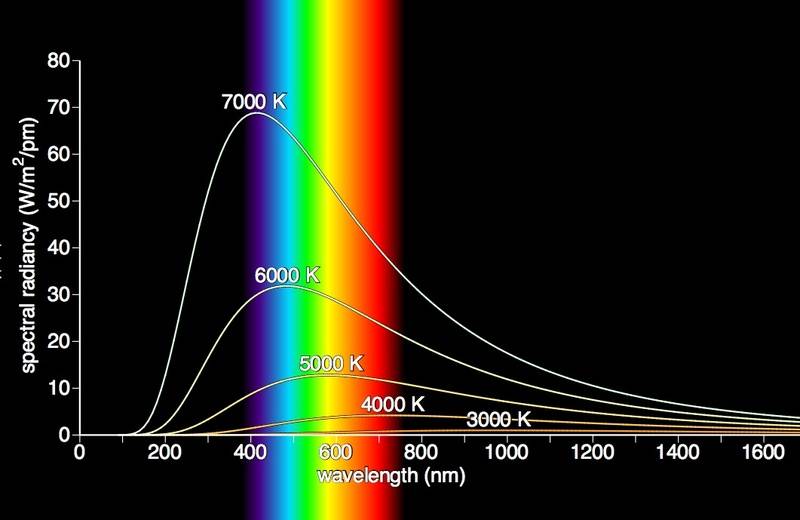

Let's consider main sequence stars, for simplicity. There are two concepts in astrophysics which together completely answer your question:
1) Mass-Luminosity relation (more massive stars are brighter)
2) Relationship between effective temperature (or spectral class or "color" of the star) and the luminosity of the star, known as HR diagram. In short, this relation is showing that stars with higher effective surface temperature are brighter.
Combining both concepts together, it is obvious that, that more massive stars have higher effective temperature, i.e. color closer to the blue part of spectrum. Less massive stars are closer to the red end of spectrum. The effective temperature itself indicate what is the wavelength where most of the intensity is radiated away by a star (following the Wien's law for blackbody radiation).

I understood that his main concern is the relation between the stellar mass and the peak wavelength of the spectrum (the most represented "color" in the star's spectrum), but maybe I am wrong. I ignored the effects caused by perception of light by human eye (and brain), but maybe this is the main concern of OP. Let's see whether we get some feedback, it happens quite often that OP loses his/her interest after posting the first question...
stefan r said:
Does the star's evolution matter?
Yes, it does, as far as we still talk about the "mass-color" relation. As you pointed out, red dwarf and red giant might have the same effective temperature (i.e. "color") but their masses are different in general, so you cannot define 1:1 relation for all kind of stars. The 1:1 relation can be done per single luminosity class, e.g. for main sequence stars (or more strictly for Zero Age Main Sequence stars). As the stars evolves it is getting further away from the main diagonal on the HR diagram. So getting back to example with red dwarf and red giant, the two stars are in different evolution stages, and part of different MK luminosity classes. The mass-temperature relation won't work. Fortunately, the luminosity classes can be distinguished due to effect of http://www.faculty.virginia.edu/ASTR5610/lectures/LECTURE2/A3I_Vpressbroadphoto.jpg.
