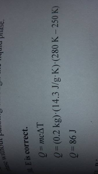

This is an image of the solution in the book
It seems that the typist omitted the k in the answer. An easy mistake to make.
Okay. Thank you for confirming that it's a mistake. It's actually amuch bigger mistakes and then just a missing k. The original question was multiple choice with the possible answers being 46 joules 72 tools 56 joules 35 joules in 86 joules.
Thank you so much for helping! You saved me hours of misery . Textbook mistakes when you are self teaching are absolutely devastating.
