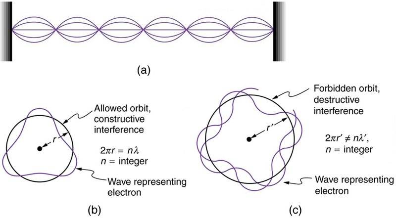

According to Louis de Broglie, particles can act like waves. Therefore, an electron orbiting a nucleus could be interpreted as a standing wave, with only an integer amount of wavelengths being allowed. Higher energy electrons can pack more wavelengths into their orbit. The longest wavelength is the lowest energy an electron can possess, and that represents the ground state. An electron can therefore get no nearer the nucleus.
de Broglie published this hypothesis in 1924. Physics has advanced since then and the model you quote for the orbitals is severely antiquated. In my opinion, the use of this type of models in popular science is the reason we have people coming here who think they can do physics just by quoting ideas similar to this one. What people do not realize is that these models are old and at best analogies and approximations of the actual theory.
I would say that the basic principles of quantum physics have not changed much since the early decades of the 20th century. De Broglie's picture basically became the Schrodinger equation, still in use today. I could say the integer wavelengths represent energy eigenstates, but it's basically the same thing. You mentioned energy eigenstates yourself - discovered in the 1920s! Nothing wrong with old stuff! I think the integer wavelength is quite an intuitive way of looking at it.
The problem with the de Broglie picture is that it is giving the appearance of the electron having a classical circular orbit. You will agree that this is certainly not the case. The Schrödinger equation is three-dimensional and the appropriate solutions in the angular directions are the spherical harmonics. It is certainly not about the electron "travelling" as a wave around the nucleus.
