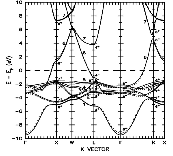

This is the full band structure of copper:
You'll notice that it isn't "flat", especially the conduction band.
As NaOH is trying to tell you, your band diagram is a "cartoon" picture simply to indicate where the available states are. It is really a reduced picture where the momentum k has been integrated out, leaving only the available energy states. This means that the electrons in the bands are characterized by not just energy, but also momentum (E, k). So while they may occupy the same energy, there is degeneracy in the form of differing momentum, resulting in a band dispersion. This does not result in an overall "flat" curves.
Zz.

Look at the valence band structure of copper! There's a lot of curving lines there! And again, there are degeneracies!
Zz.
