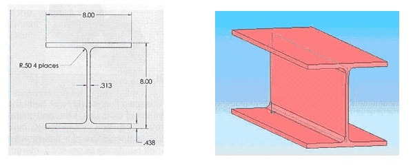

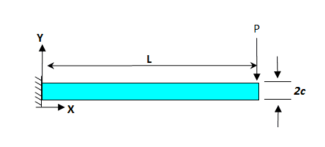

Hello,
i would like to ask You a question about difference in results between Euler-Bernoulli method of analysis of stress in short slender beam and 3D FEA method mentioned in ansys aim tutorial here: https://confluence.cornell.edu/pages/viewpage.action?pageId=33636829
The problem looks like this:
where P = 1000 lbf, L = 24 in, c = 4 in. P is applied force only in -y direction
Problem: The Result of simgaX (normal stress in x direction) after hand calculation (850psi) using Bernoullis model is two times smaller than result obtained using FEA in ANSYS (1800psi).
Here is hand calculation using Euler-Bernoulli theory:
HOwever, as i mentioned, the result form ansys for sigmaX is 1833psi.
What is worng with that theory?
In that tutorial here: https://confluence.cornell.edu/pages/viewpage.action?pageId=3363682 It is mentioned that "substantial out-of-plane stresses (sigmaZ, simgaY) result in Poisson effects on the normal wall stress (sigmaX), increasing its value substantially".
I understand that sigmaZ (710psi according to ansys) is due to the fixation of this beam however sigmaZ is positive = its tensile. simgaX is also tensile so sigmaX should be REDUCED according to Poisson effect. And according to ANSYS it really is because overall equivalent stress (1400psi) is actually smaller than sigmaX (1800psi). (Its due to the fact that all stresses are tensile ( i talk about point above neutral axis)
But it is still much higher than simgaX of Bernoulli
https://ctrlv.cz/F1mf - this shows only representation of stresses
So the big difference in simgaX between Euler-Bernoulli (sigmaX=850) and 3D FEA ANSYS method (sigmaX=1800psi) can not be caused by out of plane stress.I would like to ask, why is the real value of sigmaX almost two times higher than it is according to Euler-Bernoulli beam theory?
Is it due to the fact, that beam is short and has it sth to do with shear stress?
What theory can be used to calculate analytically more accurately the value of sigmaX (i mean value close to the reality) ?
I know that simgaZ is zero according to euler and that it is not true, but it should decrease sigmaX and not increase it...
It seems so simple, so please answer me.

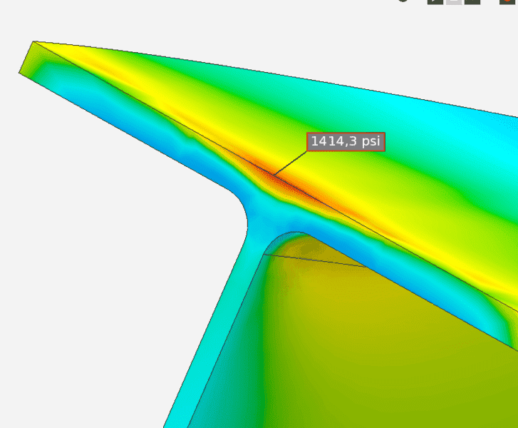

Thanks for detailed explanation. Yes, as u mentioned, the maximum combined stress is confined to a pretty small strip across the top edge of the beam: https://ctrlv.cz/NEZv
Vertical shering stress means, that Euler-Bernoulli theory will not work properly therefore this equation:
will not get meaningfull answers for SigmaXmax.
Now i am googling about limitations of Euler-Bernoulli theory and it seems that in Euelr-Bernoulli theory a rotation between the cross section and the bending line is not allowed. This rotation comes from a shear deformation, which is not included in a Bernoulli beam. Therefore, the Bernoulli beam is stiffer.
Am i right?

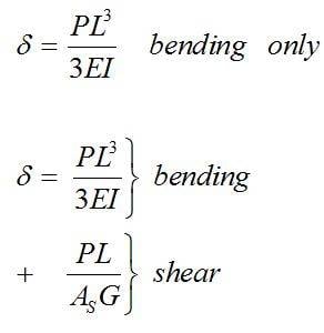

I am not clear on what a "rotation between the cross section and the bending line" describes; but, one quick way to determine the relative stiffness between the example FEA analysis and a classic Euler-Bernoulli beam analysis is to compare the beam's end deflection of each. Comparing the stresses calculated by FEA vs classical analysis to test the validity of an FEA result is difficult; but, in the past, I have found that comparing the deflections between the the two methods is a straight forward and reliable method. Small variances can be expected but any major variance is definite cause for a careful review of the two analyses.
Difference in deflection is only about 4%. But difference in stress is like 100%
The reason why the difference in deflection is only 4% is that in calculation of deflection can be easily included deflection from shear stress
where the relevant shear area is approximately the area of the beam web only.
As you stated " the relevant area is in the area of the beam web where the stresses are apparently not high enough relative to the extreme fiber stress on the outer face of the flange or the increase would have a more significant effect on the beam deflection than 4%. This does not mean that the information and its effect on the beam deflection are not of interest but to make a statement "that it increases the stress 100%" without stating where it is and how or if it affects the critical stresses in a component (such as the last statement about the location being on the web) is pointless.
