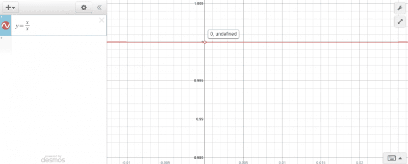

Why Graphing Tools doesn't represent hole in a graph of a function. A Hole at a point in a graph is point where function is not defined.Suppose there is a function
##\frac{x}{\root{x-1}-1}##
Its should be like this
But online tools and even my android graphing tool app shows graph like this
What I'm saying is that, apart from circle there must be some sort of marks representing that the function is not defined here.

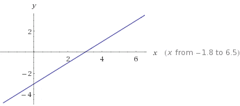

What's your function? Plotting ## \frac{x}{\sqrt{x-1}-1} ## gives me a different graph.
Anyhow, point discontinuities aren't always shown on generated graphics, but you can force the tool to do it.
For example, take the function ## \frac{x^2-5x+6}{x-2} ## which has a point discontinuity at ##x=2##.
Using WolframAlpha:
>> plot (x^2-5x+6)/(x-2)gives this:
>>plot discontinuities of (x^2-5x+6)/(x-2) gives this:
Now, as for why these graphic tools don't show where point-discontinuities are? I don't know, I guess you have to ask for it, because we usually don't need to see it shown that big. Theoretically, the exact point ##x=2## in our example is so small if it were to be shown it would be unnoticeable. Note that the function behaves at ##x=1.9999999...## exactly how it does right after ##x=2##. The circle of point-discontinuity is just a symbol showing that something is going on here; it's not a real hole because point-discontinuties are actually impossible to show.
About online graphing websites [for example Desmos]:
I think that because the program is trying to show that the function is continuous on a very close interval beside the point where the function has a discontinuity, but if you click on that point it will give you its coordinate and whether it is defined or not.
