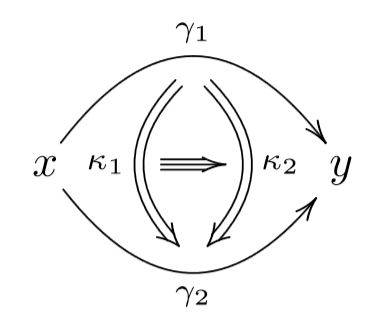

Yes, that's one good way of thinking about it. This is the motivation from "higher parallel transport".
Like so: the structure of a group (an ordinary group) is exactly what one needs in order to label the edges in a lattice gauge theory: the group product and associativity give that edge labels may be composed, and inverses gives that going back and forth along the same edge picks up no curvature. Of course this is not restricted to the lattice. In general, group-valued gauge fields are exactly the right data to have consistent Wilson line observables
Now a 2-group (categorical group) is, similarly, exactly the data needed to consistencly label edges AND plaquettes in a consistent way (with possibly different labels for each). For instance associativity now includes a 2-dimensional codition which says that with four plaquettes arranged in a square, then first composing horizontally and then vertically is the same (in fact: is gauge equivalent to) first composing vertically and then horizontally.
Again this is not restricted to the lattice. Generally, 2-group valued gauge fields are exactly what one needs for consistent Wilson surfaces.

The story goes like so: In the 70s logician Per Martin-Löf comes up with the modern foundation of computer science, now known as intuitionistic type theory (where "type" is short for "data type", such as "Boolean" or "Integer".) This type theory is an absolute minimum of logic, as Martin-Löf lays out very enjoyably here:
Per Martin-Löf,
"On the Meanings of the Logical Constants and the Justifications of the Logical Laws",
Nordic Journal of Philosophical Logic, 1(1): 11–60, 1996,
(pdf)
Moreover, this type theory is fully constructive, meaning roughly that it regards everything as a computer program.
In particular it thus regards assertions of equality as computer programs: The assertion ##x = y## is to be understood as a computer program ##\gamma_1 ## which checks that indeed ##x## equals ##y##. This brings with it the curious possibility that there can be another program ##\gamma_2## which also proves that ##x## equals ##y##.
First, Martin-Löf distrusts his own theory, feeling that this would be weird, and imposes the ad hoc extra rule (the axiom of uniqueness of identity proofs) saying that any two such computer programs, proving ##x = y## must in fact be equal. But eventually it is realized that such an ad hoc rule is awkward and breaks various nice properties of the system. Hence it is removed again, sticking with the minimal theory.
But this minimal theory now has a maximally rich behaviour: To ask whether the two programs ##\gamma_1## and ##\gamma_2## are equal or not, one now needs to invoke yet another program ##\kappa## which checks ##\gamma_1 = \gamma_2##.
And again there may be two different such programs, ##\kappa_1## and ##\kappa_2##, and to tell whether they are equal, we need to invoke yet another computer program
And so ever on. (Graphics taken from Higher Structures in Mathematics and Physics.)
For decades nobody in computer science new what to make of this. Then suddenly there was a little revolution, when it was realized that this minimal theory of computation with this curious rich inner structure is secretly the formal computer language for homotopy theory and higher category theory: It automatically regards data types as homotopy types. Ever since, Per Martin-Löf's type theory is now called homotopy type theory.
This a new foundation of mathematics rooted in computer science and flourishing into higher category theory. It may be argued that it also provides foundations for modern physics, see at Modern Physics formalized in Modal Homotopy Type Theory.
