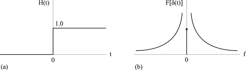

Not only one? for example the 50Hz at home
No. An impulse or a step input both have components of frequencies from low to very high. It take very high frequencies to give the sharp increase. Here is the unit step function in the time domain and its associated frequency spectrum:
Of course, if you want to describe the time-dependence of such processes you need to solve the complete differential equation, including the transient states implementing the initial conditions. Of course you can work with Fourier transformations or, since you have an initial-value problem, somewhat more conveniently with the Laplace transformation (the latter being the preferred method by electrical engineers, while physicists usually prefer the Fourier transformation).
