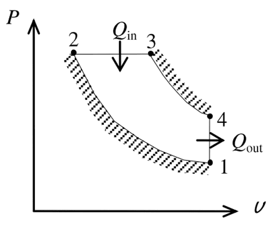

What is the definition of cutoff ratio?
tracker890 Source h said:
Q: Why is 2.4-L referred to as the maximum volume instead of the displacement volume in Example 9-60?
Post #1 has too many links to read through and it is not clear why you have included them.
However, in the model answer for Example 9.60, the author uses ##V_1= 0.0024m^3 (=2.4L)## which, as you say, is incorrect. (I get ##V_1 = 2.514L##.) Presumably that's the problem about which you are asking.
So it looks like a simple mistake by the author.
Likes tracker890 Source h
$$r_c=\frac{V_3}{V_2}$$
