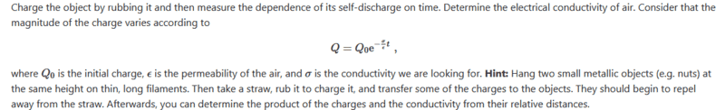

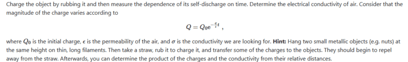

Can you post the assignment exactly as was given to you? Is the straw & nut idea yours or is it required by the assignment?
I just need to make the nuts repulsing from the straw, the rest won't be any problem.
Thank you for posting the statement. I wonder if the person who suggested it has actually done it and collected useful data. I note the casual statement " . . . then transfer some of the charges to the object." That's your sticky point. Since the "objects" are conductors, the most reliable way to transfer charge to them is by induction. Try it.
Well, at least we are starting to get somewhere. Posting the exact question n- which, granted, means admitting it was schoolwork and belongs there, but that can't be helped - would have been a good start.
How big is your nut? You want an itty bitty one. If it;s easy to thread the string, it is almost certainly too big. This won't work with a truck lug nut.
As a PS. Since it's an assignment (which you should have told us) you probably can't change anything, but using a nut is, well, nutty. Use a piece of down. The down will be initially attracted to the charge, and once it tuches it, repelled. No string required,

There are some puzzles in the question statement.
First, why two nuts? I suggest it meant to say "begin to repel each other".
Second, how does the hint relate to the task? Is the idea to do this twice, waiting different times before charging the nuts?
As for how to charge the nuts, yes, induction is likely to be more effective, but the word "transfer" implies contact. That would transfer some charge, but you would need to slide the straw around so that the nut gets to touch a lot of the straw's surface.
Note also that induction will lead to the nuts being positively charged, so attracted to the straw but maybe repelling each other.
I say "maybe" because as @Drakkith points out in post #2 the charges in the nut will redistribute when exposed to a field. Indeed, like-charged conductors can attract! To minimise that effect, you want the nuts to be thin (washers, even) but not allowed to rotate much. You need them to remain facing each other square-on. Tie each with two strings that form a wide angle.
If you set it up with the string pairs suspended from the same two points, so that initially the washers are flat against each other, you could then use induction to charge both and watch them separate. You will have just reinvented the electroscope.

And I still think that when I am to measure the dependence of the straw's self-discharge on time, I am to measure its ##Q## dependent on time, but that is only my opinion.
Since the problem statement only expects you to be able to find the product of the charges, the question setter clearly understood that you cannot find the individual charges in the asymmetric (washer and straw) model.
Different discharge rates is a problem, though. You can only find the sum of the ##\sigma## values.
With two balloons you can assume the discharge rates are the same, but I am not sure about washer and straw.
