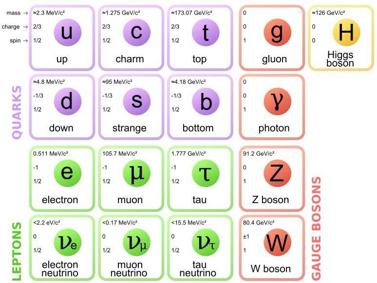

Why is c quark heavier than s while u is lighter than d?

Why are charm quarks (+2/3e) heavier than strange quarks (-1/3 e) while up quarks (+2/3e) are lighter than down quarks (-1/3e)?
No one knows. In the standard model, the quark masses are free parameters.
-1/3, not -1/2, but I guess that is a typo.

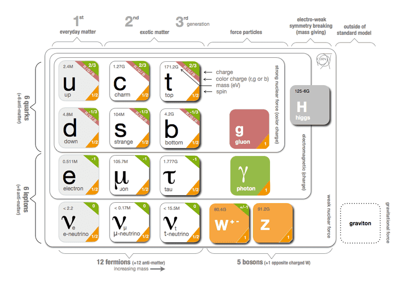

My question was about +2/3 charged u being lighter than -1/3 charged d, while +2/3 charged c being heavier than -1/3 charged s. Huge mass differences between different generations doesn't seem that abnormal, I think.
If fourth generation quarks exist, I would say that they will have much more mass than top quark, let's say tens of tev range. In the wikipedia article, it says that fourth generation fermions and further are unlikely. It also says "According to the results of the statistical analysis by researchers from CERN, and Humboldt University of Berlin, the existence of further fermions can be excluded with a probability of 99.99999% (5.3 sigma)", as far as I've understood, it is probably referring about the fifth generation.
Note 1: Where did you find this standard model? It looks weird. o_O Why is graviton excluded from the table?
Note 2: I couldn't correct the title, I don't have access to the editing options now, it's probably because it has been a I little while since this was posted. But it is unimportant, everyone understood my question right.
I fixed the title.
That's a specific model they exclude.
The hypothetical graviton is not part of the Standard Model.

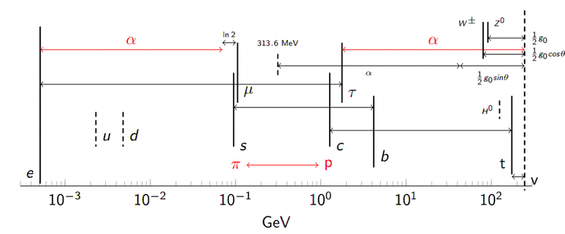

Garlic said:
Huge mass differences between different generations doesn't seem that abnormal, I think..
You are partly right. Looking at the whole thing, up and down look to be just in middle ground,
but this is because of the already very small mass of electron. Most of the game seems to happen near to the QCD scale, and in this sense top is abnormal. Which is funny, because really is the only normal ("natural") one, near of the Higgs mass and electroweak vacuum scale.
mfb said:
about personal speculations.
On other hand, I really would like to hear your opinions -and the ideas of other physicists of the group- about this question. Not an answer, as we already agree there is none, but which is your hunch about this inversion: a still unseen quantum number? Some GUT thing? Pure randomness of yukawa couplings? Differente perturbative effects in the +1/2 or -1/2 sector of isospin? I find hard to believe that people has never stopped to think this kind of things, even if they are not its main field of research.
as I was told once, and I agree, the picture you posted becomes even worse if you also include neutrinos...(although neutrinos are a little different if they don't get their masses like the rest of particles).
the picture then becomes way more unclear, covers large orders of magnitudes (from meV to MeV ~1,000,000,000 , so 9 orders of magnitude larger axis from the left), the neutrinos are very close to each other compared to the rest of particles and in my opinion the overall pic looks uncorrelated. So I'd go with "pure randomness of yukawa couplings" for now. If there is some GUT which would actually bring the fermions all-together then probably you can get some relationship between their masses once the GUT is broken, I think.
We don't know. They could have a hierarchy similar to the quark masses.
The ratio between the heaviest and the intermediate neutrino mass eigenstate is at most ~6, but the lightest one does not have a lower limit.
