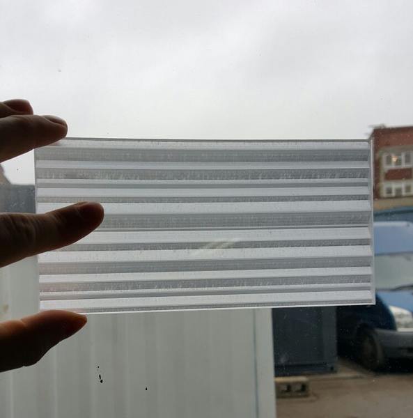

Hello, we routed V-shaped grooves in an acrylic panel using a CNC milling machine and placed the panel in front of my window, with no direct light hitting it.
The pictures below show two cases, in the top picture, the grooves are facing the window and on the bottom one the grooves are facing us. Note that when the grooves are facing us, the diffused light seems to have been captured.
I cannot explain how this is happening but would like to use this technique to harvest light in a building similarly to this old technique called "Prismatic Glass": http://files.umwblogs.org/blogs.dir/7608/files/glass/prismatic.pdf
How is the diffused light captured or redirected since it has no clear direction unlike direct light? How can you explain the differences in luminescence in the two picture below under diffused light?

I think it's just a matter of which orientation bends light more away from your camera's line of sight than the other one.

There are two parts to the scene outside.The top bit is light and the bottom bit is dark (the ground). More light from the sky is being directed in your direction for one set of faces and more light from the ground through the other set. The fact that the light is diffuse just means that it is fairly uniform, coming from the sky over a wide range of angles. The 'ground' portion of the scene is not so uniform and that shows itself in the difference in brightness from side to side on the dark bands.

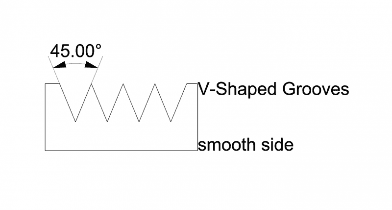

Hello @sophiecentaur thank you very much for your reply. The grooves are 45 degrees inwards. Please see diagram below.

Thanks for that. I should say that light coming from below the horizontal is hitting. the upward facing surfaces and going almost straight through and being reflected (externally) off the outside of the downward facing surfaces. So you see light from the ground in the downward facing surfaces. Light that's arriving from a roughly horizontal direction will be totally internally reflected on the insides of the wedges and deflected right upwards at around 45° or downwards at around 45°. (Your photo doesn't show this because of the direction of the shot). Light arriving from the sky will be passing through the upward facing surfaces and reflected on the downward facing surfaces.
That argument more or less explains your picture. (I hope)
If you want to achieve what the 'prismatic glass' system uses then your V shapes would need to be asymmetrical (the rough picture in the link shows this - if you are expecting to find it). Afaics, light from above the horizontal will pass through the back flat side, hit the backs of the steeper sides (facing downwards) and be reflected in a horizontal direction, into the room. You could experiment with your panels and a laser pointer to see where rays actually go when passing through. If you have a machining facility, you could try a few different prism shapes on a small scale. The faces will need to be pretty well polished.
Plastic may not be a suitable as glass because of its lower refractive index. The system in the link will reflect light (internally and off the downward faces).
