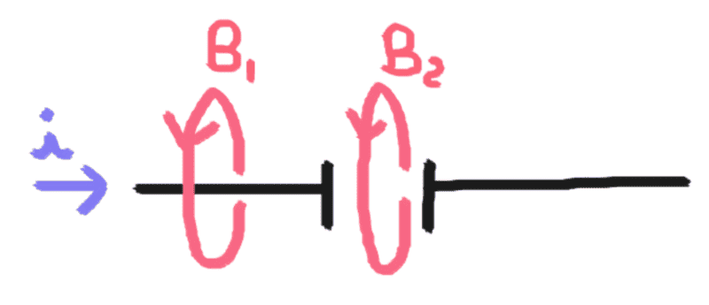

I had a question in my textbook asking why is the magnetic field generated by the displacement current in a capacitor more difficult to be measured than the magnetic field generated by the current in the wire. But I don't know how is this type of magnetic field measured, I only know that they have to be the same in either case because the current in the wire is the same as the displacement current, therefore by Ampere's law they have to be the same. (In a region out of the capacitor!)
Where would you put the measurement device in the two cases? How well does that work?

I'll try to explain better my confusion:
## \oint_C\vec{B}\cdot\vec{dl}=\mu_0(i+i_d)## such that ##C## is a curve with radius great enough to be out of the wire and out of the capacitor.
We all agree that ##i=i_d## right ? By this reason, following the equation I wrote above, why would ##B_1 \neq B_2## and therefore, why would ##B_2## be more difficult to be measured?

I suggest simply posing the problem and solving it mathematically. Take parallel-plate capacitor with very large plates which is fed by very thin wires. Take a contour around the current-carrying section. If the current is large controur is small you can ignore the electric field and use ##\nabla\times\vec{B}=\mu_0 \vec{J}##, and you will get one value for magnetic field. Next take a contour inside the capacitor, use ##\nabla\times\vec{B}=\dot{\vec{E}}/c^2##, get the second value. Then compare.

By the way your picture is somewhat messed up. Either you make your second contour much smaller than capacitor plates, then you have simple uniform electric field, i. e. displacement current, or you make your contour large, but the electric field now becomes all complicated (due to edges of the capacitor). In the first case you will measure small magnetic field because you only capture part of the 'displacement current', in the second case the magnetic field is small because you are far away from the wire. Take your pick.
I agree, it is small, but is it different than the magnetic field measured at the same distance in the current part?

So returning to the main question. Why is it more difficult to be measured?
From the RF engineering perspective. I would say it's because most physical electronic capacitors do not to radiate. The closely-spaced plates means the electric filed coupling between the two halves approaches 100% so the displacement current term is very low.
The physical capacitors that do radiate because the capacitive element separation is a sizable fraction of the time varying signals wavelength are normally called antennas.
