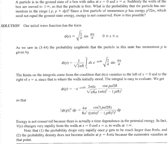

Consider a particle in the ground state of a infinite well with sides at ##x=0## and ##x=a##. The ground-state energy ##E_1=\frac{\hbar^2\pi^2}{2ma^2}##. The energy of the particle is entirely kinetic. Hence, ##E_1=\frac{p^2}{2m}##. Solving for ##p##, we get ##p=\pm\frac{\hbar\pi}{a}##. So the momentum ##p## of the particle can only take on one of these two values. In other words, we expect the wave function ##\phi(p)## in momentum space to peak at these two values: ##\phi(p)=\frac{1}{2}\delta(p+\frac{\hbar\pi}{a})+\frac{1}{2}\delta(p-\frac{\hbar\pi}{a})##, where ##\delta## is the Dirac delta function. But ##\phi(p)## is calculated to be ##\phi(p)=e^{-ipa/2\hbar}\frac{2\pi/a}{\sqrt{\pi\hbar a}}\frac{cos(pa/2\hbar)}{(\pi/a)^2-(p/\hbar)^2)^2}## (see 3rd equation in the picture1).
We are led to conclude that ##E\neq\frac{p^2}{2m}##, or equivalently, the energy of the particle is not entirely kinetic. But why?
1There is a typo in the text: an ##i## is missing in the exponent in the expression for ##\phi(p)## and there shouldn't be a negative sign. Reference: http://en.wikipedia.org/wiki/Uncertainty_principle#Particle_in_a_box
Source: Quantum Physics, 3rd Edition by Gasiorowicz, p. 57.

As the walls are removed, the „outside” potential drops from +infinity to 0, thus is no longer constant. How could energy be conserved? Side note: I congratulate you for opening this topic.
p is not a self-adjoint operator in case of the particle in a box problem. Hence your argument breaks down. However, p^2 remains well defined. This is treated in most texts on functional analysis. My preferred reference is Akhieser, Glazman,

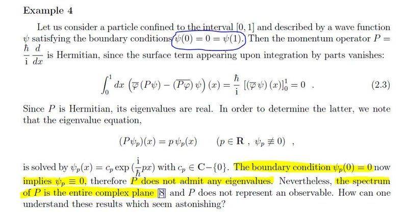

In the other thread I mentioned the Bonneau article, here I quote the one by Gieres. It all has to do with the so-called "physical boundary conditions" in which the Hamiltonian is a self-adjoint operator, but the momentum not.

Any physical reasons why momentum ##p## does not represent an observable? If we measure the momentum of the particle, what would be observed? Or what makes it physically impossible to measure the momentum?

What you've shown is Hermiticity but not self-adjointness. For an operator to be self-adjoint its co-domain must be in the Hilbert space and you should have corresponding eigenvectors. The eigenvectors of ##\hat{p}=-\mathrm{i} \mathrm{d}_x## are ##u_p(x)=N \exp(-\mathrm{i} p x)##, but they are not in the Hilbert space discussed since the boundary conditions are not fulfilled for any ##p \in \mathbb{R}##.
Note that for periodic boundary conditions the operator is self-adjoint on the corresponding Hilbert space leading to the exponential form of the Fourier series.

No, p isn't bounded, i.e. it is not defined on all of hilbert space.
For an unbounded operator to be self adjoint, it has to be:
1. Hermitian
2. Defined on a dense subset of H
3. This domain has to coincide with the domain of the adjoint operator.
