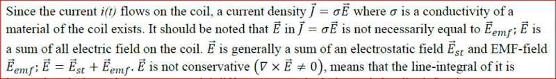

Hello.
I've summarized an inductor in my own material which is now uploaded here.
On the inductor coil, there is not only EMF-field but also an electrostatic field. In principle, the line integral of a sum of these field along the coil gives a potential difference or voltage on the inductor. However, the line integral of the electrostatic field along the coil is very close to zero as one-round line integral of this field is zero. As a result, EMF-field is a practically only contribution to the voltage on the inductor.
Please give me any comments if you don't like my physics interpretation.
  • Inductor.pdf
That particular author appears to define EMF as magnetically induced
and Est as produced by old fashioned ohmic drop
be aware that is his choice , it's his book after all
His Eemf arises from the QVcrossB term in Lorentz force
and his Est term from the QE term in Lorentz.

I agree of course, EMF it is an induced voltage in a coil measured in V.
It could be split in a effective or main EMF-in a transformer magnetic core-and a leakage
one [in vicinity air or oil or else] and it is a scalar.
E=ρ*J is a vector represented an electric field intensity [or electric field strength]
The module is measured in V/m.
If E=gradient(V) then V=integral[E*dl] and then along a conductor:
E=ρ*J then V=integral( ρ*J*dl]=ρ*length*I/sq=R*I [sq=cross section area-J=I/sq].
That means the electric field intensity is constant along a wire and this voltage it is not negligible [always]:smile:.
