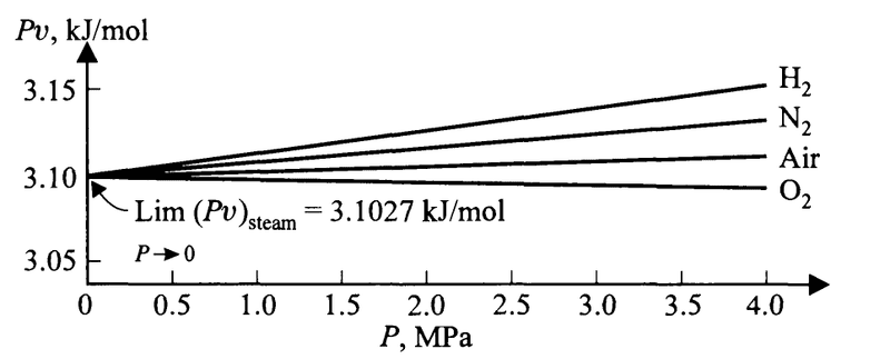

If we vary pressure ##P## and measure the corresponding values of volume ##V##, we can make a plot of ##P\frac{V}{n}=Pv## against ##P##.
This gives us some graph which has some form. Turns out that for a range of pressure starting at 0 the graph is approximately linear. At higher pressures, it becomes more nonlinear.
We can model this relationship using a power series
$$Pv=A(1+BP+CP^2+...)\tag{1}$$
Empirically, we see that for any such plot (ie, for any gas), the vertical intercept is the same. That is, ##A## is the same in the power series.

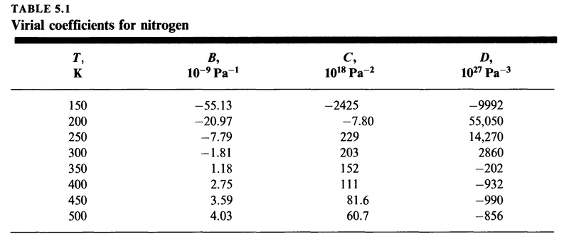

Consider the following table
Here we have estimates for the virial coefficients in (7) for nitrogen gas.
Why is the formulation in (7) interesting?

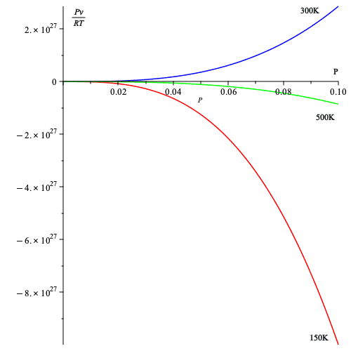

- Below, I take the values of the table above for three temperatures and plot equation (7).
Thus, it seems that (7) allows us to gauge deviation from ideal gas behavior in a relatively simple way, namely deviation from 1.

zenterix said:
TL;DR Summary: There is a derivation in the book Heat and Thermodynamics by Zemansky and Dittman which links the ideal gas law to an empirical power series equation relating ##Pv## and ##P##. The final equation of the derivation is ##\frac{Pv}{RT}=1+BP+CP^2+...## and there is a table with the estimated virial coefficients for nitrogen gas. I would like to know what makes this particular form of the equation interesting?
- For a fixed temperature, if the value of PvRT is above 1 then I assume this means that the molar volume is larger than expected for an ideal gas. I remember reading something in the past about intermolecular forces. Is this the origin of such a discrepancy at higher pressures?
Ideal gas has no molecule volume. Real gas molecules have volume which makes upward tendency in the graph. Some real gas molecules have in general attractive forces between which makes downward tendency.

Yes. Equation 7 is a relationship for calculating the "compressibility factor" z.
