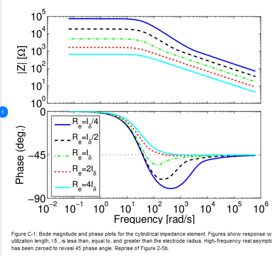

Of course it is. In general an impedance will not be purely real, and will have a Real and an Imaginary component. These are each a ratio of the Voltage and Current, so each component has units of Ohms.
There are two common ways to express this complex impedance -- With complex numbers:
$$ \mathbf{Z(f)} = Z_r(f) + jZ_i(f) $$
where both the Real and Imaginary impedances have units of Ohms, and with Magnitude and Phase notation:
$$ \mathbf{Z(f)} = Z_{mag}(f) < \theta (f) $$
where the Magnitude is in Ohms and the Phase angle ##\theta## is in radians or degrees.
The Magnitude and Phase notation is commonly used in logarithmic impedance plots from Impedance Analyzers like the HP 4194 and similar...
https://www.researchgate.net/figure...ical-impedance-element-Figures_fig13_38006544
Likes Lord Jestocost, Crimadella and DaveE
The unit of Ohms is simply the ratio of Volts and Amps. At any instant in time there is a Real scalar Value of Volts and Amps in any component.
We extend this to waveforms that vary in time, usually focusing on sinusoids of a fixed frequency. This simplifies situations where the circuit response varies in frequency and is the basis for more advanced analysis techniques like Fourier or Laplace transforms. Many circuits will cause a shift in the phase of sinusoidal waveforms as well as changes in amplitude. This phase shift is important in the behavior, so we then need to represent sinusoidal behavior with a pair of values representing both magnitude and phase. This leads to mathematical techniques based on vectors or complex numbers and such. For convenience in this analysis we extend the concept of resistance to impedance which can be represented with complex numbers but still maintain the Ohms unit. In this case it is the ratio of a sinusoidal voltage and it's associated sinusoidal current and, of course, could be frequency dependent.
In cases where we aren't dealing with a single frequency waveform, like a step or impulse response, the concept of Ohms doesn't make much sense and isn't used.
