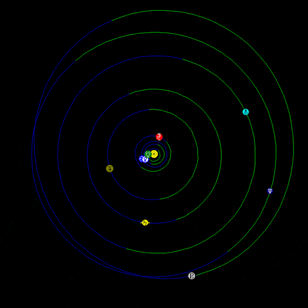

Oh, no wonder why its so bright! I thought that since we can see Jupiter and Venus at the same time side by side, and that since Venus is closer to the sun than Jupiter, with us in between, that if we see them side by side, Jupiter must be presently on the other side of the sun from Venus, but now I realize I did some bad geometry. Thanks for the response.
69AB85ECD3C29AFC41FE7AE00311E5B1FD81123654516855CE5407B3126BC9FDE57A6289A42B60313C4C514D07267C2B.gif
from here: http://www.fourmilab.ch/cgi-bin/Solar/action?sys=-Sf
