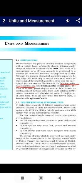

I like (digest) what you said in the later part of this post. Also your saying there are no fundamental quantities is now making some sense to me but I have in one the textbooks which is considered quite authentic they use terms like fundamental quantities and fundamental units in similar sense, I am sharing the screenshot of the page of the book.
