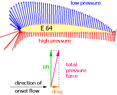

Delta2 said:
I , on the contrary, think this is the way it is defined. More specifically the lift in a wing is the following integral
$$\oint_S p\cdot \vec{n}dS$$ where ##p## the pressure in the surface of the wing and ##\vec{n}## the normal at the surface of wing at that point.
These are the local pressure forces, not lift. Local pressure forces are obviously perpendicular to the local wing surface, per definition of "pressure".

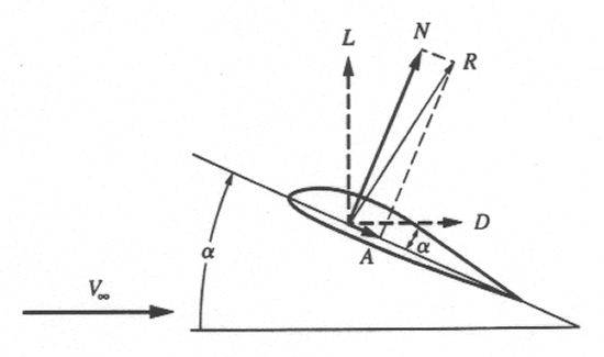

But "lift" is defined as perpendicular to the freestream relative flow, which is different than perpendicular to the local wing surface.
Difference between lift (L) and drag (D) versus normal force (N) and axial force (A)
From: http://www.aerospaceweb.org/question/aerodynamics/q0194.shtml

@A.T. if we define $$\vec{F}=\oint_S p\cdot\hat{n}dS$$ can we say that lift is the component of ##\vec{F}## perpendicular to the freestream velocity while drag is the component of ##\vec{F}## in the same direction to the freestream velocity?
Lift and drag are components of the total aerodynamic force on the object.
What you have written down doesn't include friction parallel to the local surface (which is part of the aerodynamic force) and includes buoyancy (which is not part of the aerodynamic force)
Likes etotheipi and Delta2

snorkack said:
Also remember that space has three dimensions. Does it mean that lift can have, and normally does have, out-of-plane component when freestream velocity and therefore drag are defined as in-plane forces?
I don't know what you mean by "defined as in-plane forces".
You project the aerodynamic force vector onto the freestream velocity vector to get the drag vector, and lift is simply the remaining component of aerodynamic force.

To have two linearly independent components. Since drag is 0° the remaining component is 90°.
thetexan said:
Why not 90 degrees to the chord rather than relative wind?
You can do that too, it's called normal and axial force. See diagram in post #5.

thetexan said:
The question is why is the summed lift vector always perpendicular to the relative wind?
Asked and answered: convention. It is helpful to break the aerodynamic force into perpendicular components. So we break the aerodynamic force into perpendicular components. If one is going to do this, it is good to have an axis in mind. The velocity of the free stream is a handy and useful reference.
It is exactly the same reason that we talk about normal force and frictional force: because it is a useful way to break the contact force between two objects into perpendicular components.
