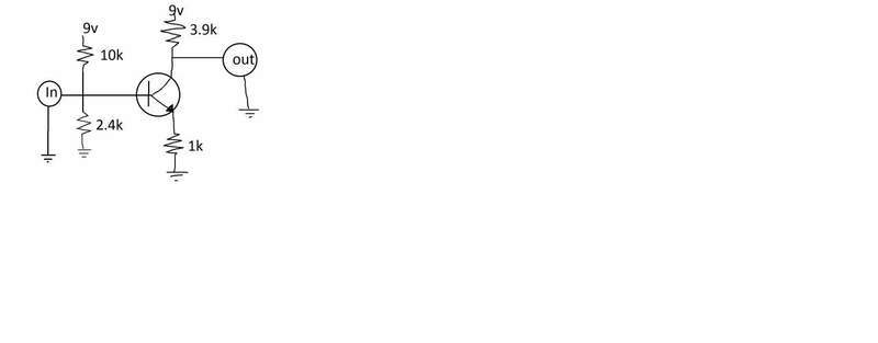

My amplifier doesn't work. The schematic with all the values are attached(it was the easiest way to show what I did). Attachment of the amp to the speaker could be the problem. When I hook the amp, I only get a faint static.
V=IR
I made an audio jack cable go from aux to two wires. One of the wires being positive and the other negative. So when I put these wires into a speaker, the speaker works with my iPod playing. However when I make the wires go through the amp, it doesn't work. I wired the + wire from the audio cable to the amp's input, the amp's output to the + side of the speaker, and the - wire to the - side of the speaker, but nothing... I apologize if I'm doing something completely ridiculous... this is my first homemade circuit! XD All constructive criticism is appreciated!

Welcome to the PF.
Can you label each node in your circuit with the voltage that you get by measuring with a voltmeter (DVM)? That will help us to be sure that your biasing for the two transistors is working correctly. Measure each node's voltage with respect to the - side of the battery.
Just as a general statement, your base bias voltages are too low and your emitter resistors (10 ohms) are way too low.
I would also check the calculations for the base bias resistors. eg Assume the base current is zero and work out what voltage the potential dividers produce. Are they reasonable?
Edit: Don't bother. Rude Man has already told you they aren't.

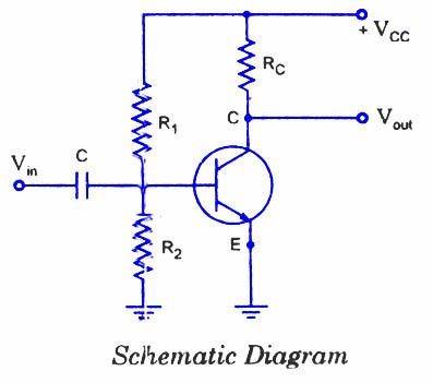

Okay guys so I have been reading a lot on this stuff and am starting to understand it a lot better, however it is still really confusing. So I decided to simplify my amp for now(See picture) but I'm unsure of what values I should choose for Ic and Rc... I also am not sure how much voltage should be at the point right before the base of the transistor. The voltage divider sets it to a certain voltage right? Well at all the examples I looked at this value is 2-3 volts, but how can I calculate the best value for this?
The voltage drop from Vcc to ground is 9 volts let's say(using a 9v batter).
This means that:
Vcc(battery) = Vrc(from Vcc to collector) + Vce(from collector to emitter) +Vre(from emitter to ground) right?
So I need to pick a value for Ic that will keep the amp on but not fully on. I looked up the max value for Ic and it says its 600 mA. The gain is 100. In the tutorial that I was following, the guy used .5 mA for the Ic, is this normal? How do you know what value to use??

I said before your emitter resistors were too low (10 ohms). So your move is to reduce them to zero?
ic = 0.5 mA is a good operating point. You might go up to 1-2 mA.
I suggest: Re = 1K, Rc = 3.9K, R1 = 2.4K, R2 = 10K giving
quiescent: ic ~ 1 mA, Vc = +5V giving you ~ 8V peak-to-peak swing at the collector.
V gain ~ 4
Then you can play around with changes.

Ok this should help...
I hope he doesn't mind but Rude Mans design process probably went like this ...
Choose VCC = 9V
Decide that 1V of that will be "used up" across the emitter resistor to set Ic. So choose Ve = 1V.
Then decide Ic = 1mA (a very common value for this sort of transistor circuit)
That mean Re calculates as Re = Ic/Ve = 1mA/1V = 1K
To get Ve = 1V the base voltage needs to be biasde to Ve+Vbe = 1.7V
We choose R1 and R2 to give:
a) Vb = 1.7V
d) The current flowing in R1 & R2 >> Ib to allow Ib to be ignored.
If Ic = 1mA and hfe were say 100 then Ib would be 0.01mA
I believe Rude Man meant R2 = 2.4K and R1 = 10K which gives
Vb = 9V * 2.4/12.4 = 1.7V as required.
Then current through R1 & R2 is about 9/12.4 = 0.7mA which is >> than Ib so the effect of Ib on Vb can be ignored.
Then what about Rc.. Well the available voltage swing is from Vcc down to about Vcc - (Ve+Vsat) = 9 - (1 + 0.3) = 7.7V Call it 8V.
Half of 8V is 4V
So we aim for Vc = Vcc - 4V
If Ic is 1mA then Rc = 4V/1mA = 4K. Nearest preferred value is 3.9K
EDIT: You are right. Some values are indeed just "choosen". For example you could choose a different value for Ic within reason.

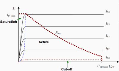

Thank you so much CWatters! That actually helped a TON! Okay I get all of it until the Rc part. What is Vsat? Why is it .3v?
Also is it always assumed that Vc is about half of the voltage drop from Vcc to Ve?
Vsat is the transistor saturation voltage. Basically transistors are not ideal devices, they are not ideal lossless switches. Take a look at the plot here..
It shows Ic vs Vce for various values of Ib. Note how on the left hand side the ability of the transistor to sink current (Ic) reduces at low Vce. In a circuit this has the effect of preventing Vce going below about 0.3V (it varies depending on the transistor and other parameters).
So in your circuit Vc can't go below about Ve + Vce no matter how hard you drive the base of the transistor.
Vsat sometmes has implications for the power dissipation. Not in this circuit but in power switches where Ic might be very large. In that case when fully ON the power dissipation in the transistor would be Vsat * Ic.

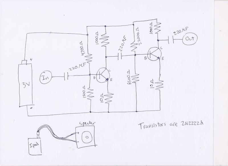

I just built the amp again. I drew the schematic for it on paint, sorry for the horrible art skills...
So it ACTUALLY works! However it isn't as loud as just directly connecting the speaker to the iPod. I mean just the fact that works is amazing but it isn't "amplifying" anything. It also has static. Do I need a filter capacitor and bypass capacitor you think? I'm researching it right now, however if you have any useful advice/links that would be greatly appreciated!
Sorry I forgot to attach the schematic!
The output of your iPod is probably a 1V max signal at reasonably low impedance, say 1K, so actually the input of my design would be OK. Pick C = 1uF to get your low frequencies into the amplifier. Change R1 to 51K and R2 to 12K, for the same reason.
Now, your real problem is with the output. Your output Z is about 4K which is way too high to drive a basic speaker. A stand-alone speaker has impedance of only about 8 ohms. Connecting such a speaker from the collector to ground will drive the collector voltage to almost zero V dc. You gain is well below 1.
We need to know the input impedance of the speaker. Speakers for pc's for example usually have built-in amplifiers so they'll have higher input impedance. Of course, then you wouldn't need your amplifier. Have you tried to hook up a powered pc speaker pair to your iPod? Should work well.
EDIT: might look at http://www.talkingelectronics.com/projects/TheTransistorAmplifier/TheTransistorAmplifier-P1.html

Well my speaker is an old stereo speaker. However I'm doing this for a project, not necessarily to get better speakers. So although buying a set of powered speakers would be cool I wouldn't get a good grade XD. However this is very interesting stuff to me and I'm really thankful for all the help!
So is there anyway I can impudence match the voltages? IDK the impudence of my speaker but how would I go about testing it? I was reading that you can use a transformer, capacitor, or resistor. From those 3 the capacitor sounds like the best option but I'm not sure what value to use for it. In the link you posted it said that capacitors can act like resistors. So since my Z is 4k ohms (which not sure how you calculated that lol) I would need a capacitor that results in a resistance bringing down the current to acceptable values? I mean let's assume my speaker is an 8 ohm one. Would I need the capacitor to act like a 3992 ohm resistor?
No, that would just divide the ooutput in half and only small part of that would make it to your speaker.
The best way would be a small step-down transformer. You'd want the turns ratio to be sqrt(4000/8) or about 22:1. Connect the primary in lieu of the collector resistor and the secondary to your speaker.
Or you could just wire your speaker inlieu of the collector resistor directly. That wouldnot work nearly as well.
