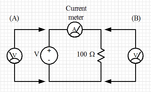

Did you measure the voltage across the supply or across the resistor? In other words, was the current-measuring DMM included as part of the "load resistance"?

This is how I set up my circuit: https://gyazo.com/72f50f46557719cabcdd93b9a31cc3dd.
So, Have I calculated the total resistance right? using the voltage output from power pack and dividing it by the current Rt=V1/A1? And the reason the calculated total resistance is higher than the theoretical total resistance and the resistor used is because there is added resistance from the DMM and power pack?
Yes, the total load resistance is ##R_t = V_1/A_1##. This would include any resistance in the connectors, wires, and current meter DMM. It would not, however, include the internal resistance of the battery (power pack) as presumably ##V_1## is being measured at its external terminals. Any voltage drop due to its internal resistance takes place where you can't see it. All you can "see" is the voltage at its terminals, which presumably you are manually adjusting to read 1 V, 2 V, 3 V, ...

If you are measuring the voltage across the power supply and the current in the circuit, then the load is everything connected to the power supply:
So something must be fishy with that DMM you're using for the current readings. Is it autoranging or do you have to select particular ranges manually for the current?
