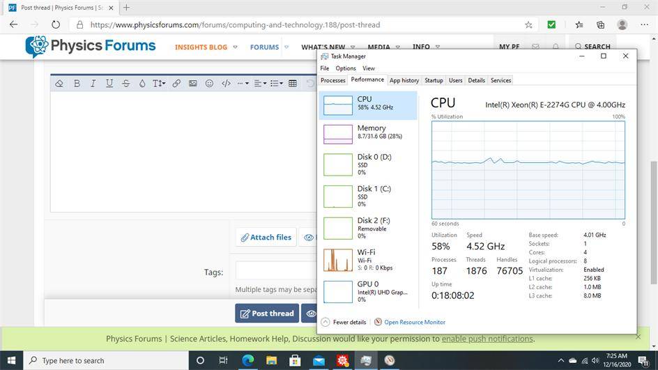

I have a Intel(R) Xeon(R) E-2274G CPU @ 4.00GHz 4.01 GHz machine which has a published max speed of 5.0 GHz. However, when I run it under load on all 4 cores, it only gets up to about 4.5 GHz: Could someone explain to me why it's not ramping up to the full 5.0 GHz or what I could do to increase the speed without overclocking it? I have a practical reason for this: I wait a long time for my work to complete so would cut down the wait time if I could do something to increase the speed.

Modern CPUs are limited by power dissipation. The speed is throttled so they don't overheat. It may well be running at 5GHZ for short periods of time. The 4.52 GHZ you are seeing is probably an average speed.

Slight error. I meant 4.9 GHz: When I purchased it from hp.com, the quoted specs were:
Intel® Xeon® E-2274G Processor (4.0GHz, up to 4.9GHz w/Boost, 8MB cache, 4 core) + Intel® UHD Graphics P630
just wondering why I can't get it up to this speed. I'm running Mathematica "ParallelTable" which is using all cores. Does the 4.9 figure apply when only one core is running or is the speed being reduced because of heat flow. If so under what conditions can I see the speed at the full published figure of 4.9 for an extended period rather then just a spike I was wondering?

Ok, sorry, didn't see this before I posted above. Basically then it's just a heat problem? Little misleading to say 4.9 when, as I watch the task manager it never gets this high or may just spike to this. Disappointing I guess. Purchased it to reduce wait time, ramped up the CPU load a bit and here I am waiting just as long as before I got it.

Did you look up the chip on Intel's?
Intel® Turbo Boost Technology 2.0 Frequency is the maximum single core frequency at which the processor is capable of operating using Intel® Turbo Boost Technology.
You are using 4 cores and keeping 2+ busy.
On that Task Manager view right click and select "Change graph to > Logical processors." What is almost certainly happening is that you have 4 or more CPU's and your program is only designed to use one of them. If that is so you will see one CPU maxed while the others are not. That is a software programming issue, the software has to be programmed to use all the available cores.
Here is a screen shot of my Mathematica session. I'm basically running a 2000 length table of Newton Iterations to find roots of very high degree polynomials of high precision using Mathematica's built-in parallel-processer "ParallelTable". This launches 4 kernels. As the iterations of each table index is completely independent of the others, I can run them in parallel (4 at a time). As you can see at the left, Mathematica is using four kernels (cores) as each kernel is reporting the table index mod 25 and the Task Manager Resource Monitor showing 8 logical cores running at 111% of maximum I think. I don't understand if HP states the CPUs can reach 4.9, why the max I see on the usage is 4.5? I'm just saying that's 4 MHz difference which is significant I think.
Read what Intel says. One core.
Your chip will run one core at 4.9 MHz and run four cores at 4.0 MHz. You're getting 4.5 MHz. That's 12% better than promised. You should be happy.

Ok sorry. Didn't quite understand what you said above. 4.5 is still pretty fast.
