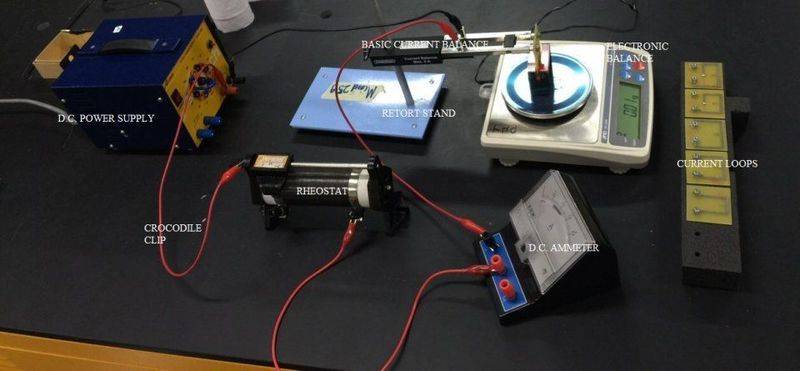

Why is the reading on my D.C. ammeter fluctuating? As in the needle won't maintain at one spot, it'll sway left and right. Also, how do i ensure that the fluctuations are minimized?

First of all, apologies for not making my statement a little bit more clearer. The experiment that I'm currently doing is measuring magnetic force with a basic current balance where the current is supposed to always stay at a constant 0.4 A. The thing is, it always fluctuate and I do not know why. Here is the set up:

oh OK, so this is related to your other thread ? ...
https://www.physicsforums.com/threads/errors-in-basic-current-balance-experiment.822864/
if so, you probably should have keep it all together and saved the confusion
so how much is the current fluctuating ?
some things I could think of that would cause fluctuations
1) variations in the power supply ... that is ... it isn't stable enough for what you are trying to do
2) its acting as a magnetometer and picking up variations in the Earth's magnetic field ... of which there's been a few over the last week or so
3) other sources of magnetic fields near your gear are causing problems with the setupcan I see a better pic of that "Basic current balance " section
cheers
Dave
Does it fluctuate if you remove the "basic current balance" part from the circuit and just use rheostat and your amperemeter?
How much does it fluctuate, and on which timescale?

Troubleshooting is an iterative process wherein one tries to draw a circle around the problem then tighten that circle like a noose.
Binary search is usually the quickest but it's not always convenient to cut a system exactly in half.. we look for convenient ways to partition the system under study.
You have two active electronic devices in your setup, both employ feedback so theoretically both are capable of control system instability.
So i'd ask - do my fluctuations stem from my active or my passive devices?
Without changing anything, i'd switch off the electronic scale. If that settles current , it's very interesting. If it doesn't settle current, well , you've eliminated half your active devices., quaternary search ?
