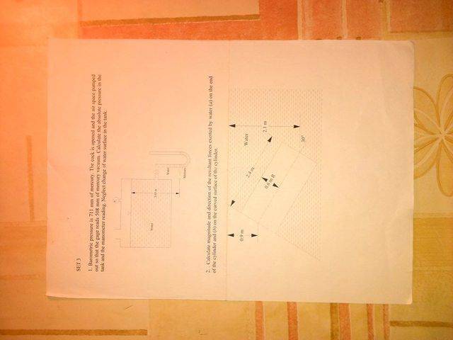

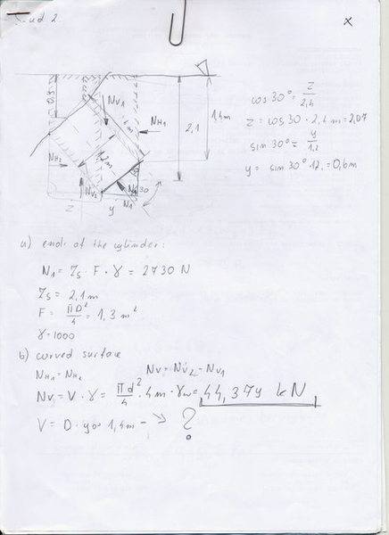

Task number 2.
The problem is that my solution is wrong but the lecturer didnt want to explain what is wrong, she insists on doing it by myself. But to be honest I'm not really good at it and I just need someone either explain it or solve or at least check it and tell me what is wrong there.
