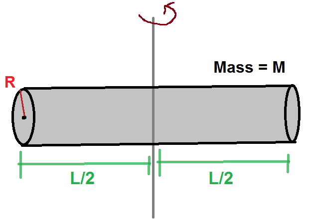

You do not explain how the magnets move inside the coil. It appears that their axis spins along the axis of your external coil because you are "making sure that the changing field is parallel to the coil". If so, they will produce minimal magnetic flux change through the coils. If you look at the video that you posted, anyone of the magnets is spinning so that its north-south axis reverses direction relative to the coil axis after half a turn. That's very important and if it doesn't happen in your setup, would be the cause of the lack of induced voltage.
It is hard to visualize what @kuruman said without a picture. Do your magnets spin as shown in this picture?
If you spin this way, it won't work.

Yes, you said with pictures what I tried to say with just words.
yes. I spin it that way. I didnt put it in the icture. But basically, i put a screwdriver in the drill, and 5 magnets on each side. I find stuff to shove between the sides to separate them. So L1 would have 5 magnets, and L2 would also have 5 magnets. The axis is the screwdriver.
