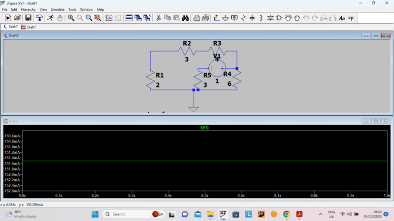

ntetlow
Attached is an ltcpice net file.
The thevenin resistance betweed the 3ohm and 6ohm resistor is 7.6 ohms. This works out as 3ohms plus the parallel value of 20||6 (4.6ohms).
My problem is - Why is this the thevenin resistance, could someone please explain?
  • thev2.txt

My LTSpice software is on a different computer from the one I'm working on right now. Can you post a couple of screenshots of your circuit and your simulation results?
Thanks for the reply. Screenshot attached.
Neil

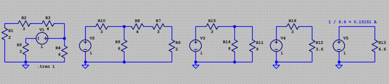

Sorry, just realised that i've sent a different version of the ltspice, instead of 20ohms as above, please read 9 ohms(2 +3+4) making the thevenin resistance 6.6ohms
What voltage is ##V_1##?
V1 is 1 volt. it is used to measure the thevenin resistance. the screenshot shows the current
The current is 151.51mA, dividing 1 by 151.51mA gives a resistance of 6.6 ohms.
That looks correct (I've deleted a couple replies of mine just now that were wrong). The 3 Ohm resistor in the ##V_1## source leg is in series with the 9//6 Ohm resistances.

Yes, I see it now, just a matter of shifting things round, I wondered if that would do it.
Thanks for your help.
